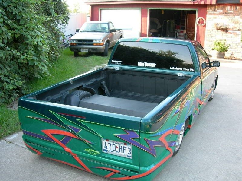

I am ready to line my bed with a bed liner. I was going to have it sprayed with line X but I've done body work in the bed and they say the body filler will peel from the heat of the line X. So I was looked into Rhino Lining it and they want almost $500 to do it. SO, I'm thinking more along the lines of doing it myself. I need to know what is the best do it yourself roll in (or spray in) bed liner out there is. I'm just going black so a color match is not needed. What's out there that's worth anything??
Here's a shot gauge took of the bed.
crazygenius13's avatar
crazygenius13
the Bed looks great, can't help you on the liner tho.
