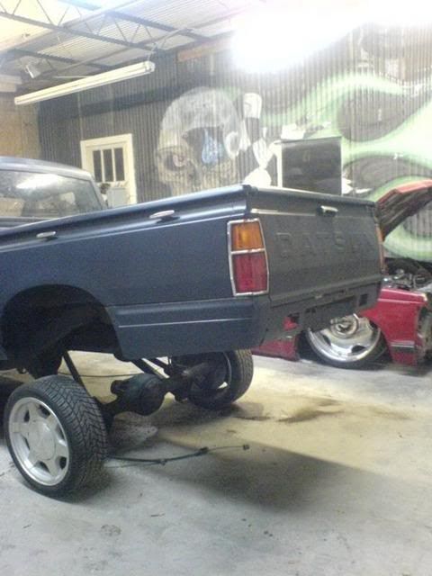

here is an old friends old truck.. rs7's, bag on bar setup.

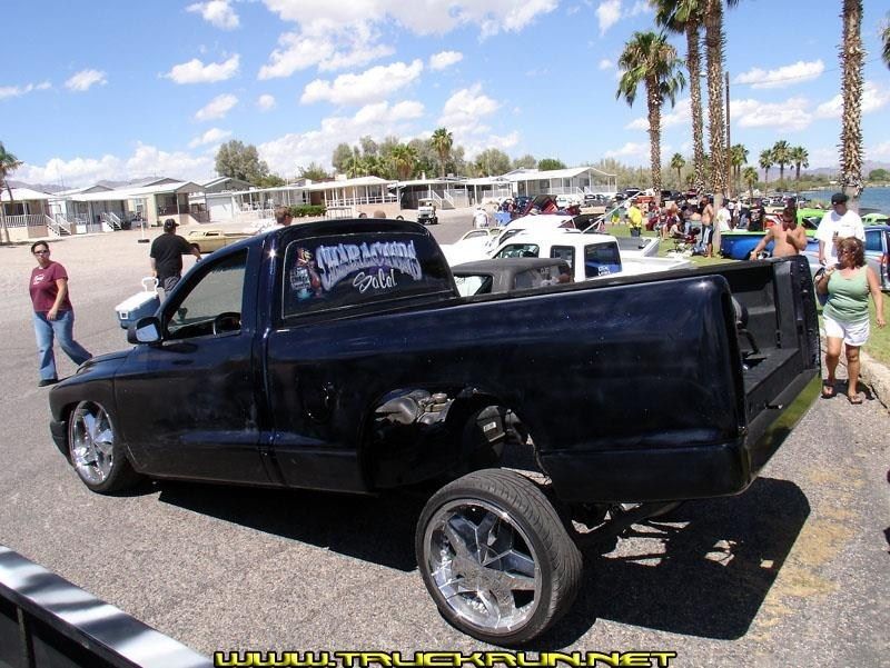

this is Jumbo's truck (sdime2372) has lots of lift.

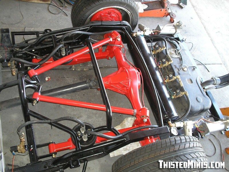

Well you asked for pictures of the actual setup, not the truck its on, so heres one I built.
I've gotten it to lift 18 inches on my shop compressor (120 PSI) and I don't doubt it will do over 20 inches.
I just don't understand the whole massive lift thing. It looks ridiculous to me, and kinf of defeats the purpose of lowering the truck.
But hey, whatever floats your bucket.
