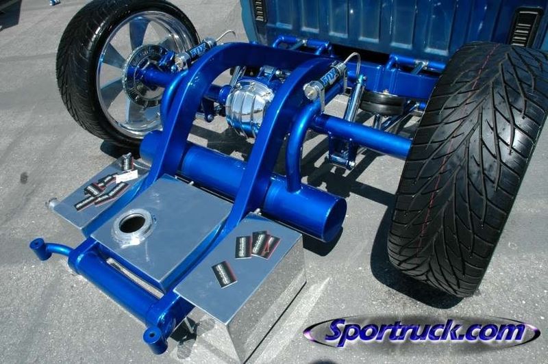

I want to do my cab mounts like the bed mounts in this pic. That's what I was talking about.
