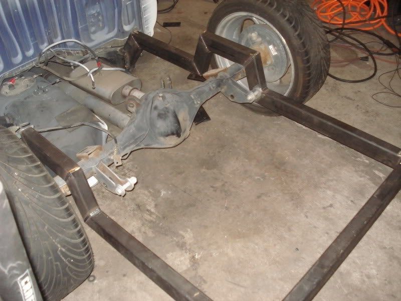

here is one im RE-doning for a guy 2x3 3/16 wall (still alot to be done to the truck)
s10
