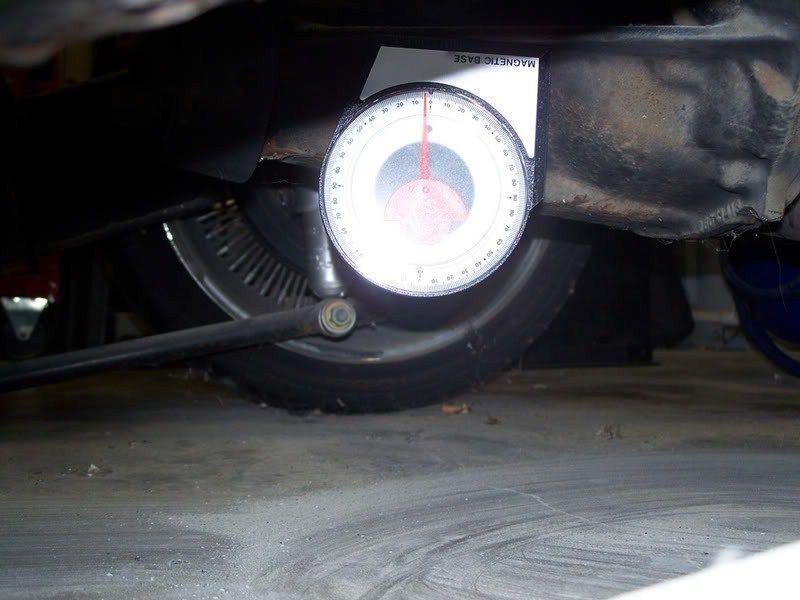

i dont think that going from +3 degrees at flat out to 0 degress at full lock is too bad, mind you this setup only provides for around 8 inches of lift, seeing that its bag behind axle setup, im not really into big wheels or hittin sides either...
anyways heres a close up of guage at flat out...

what is your pinion angle at ride height? looks like the pinoin is pointing to the ground HARD, are you measueing the angle in that vid off the spring perch or sumthing?
railmaster

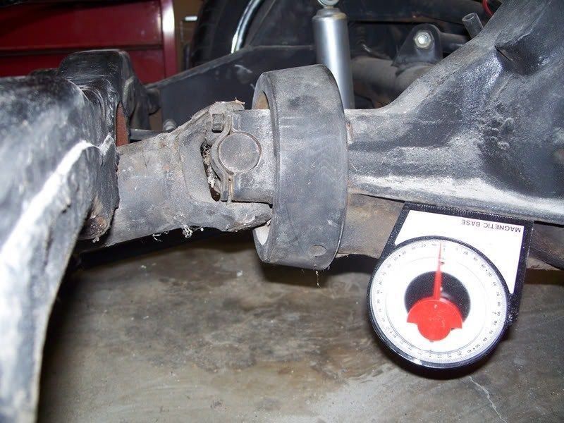

naw james its on the pumkin casting bro
railmaster
heres a pic of where the guage is at on the punkin casting

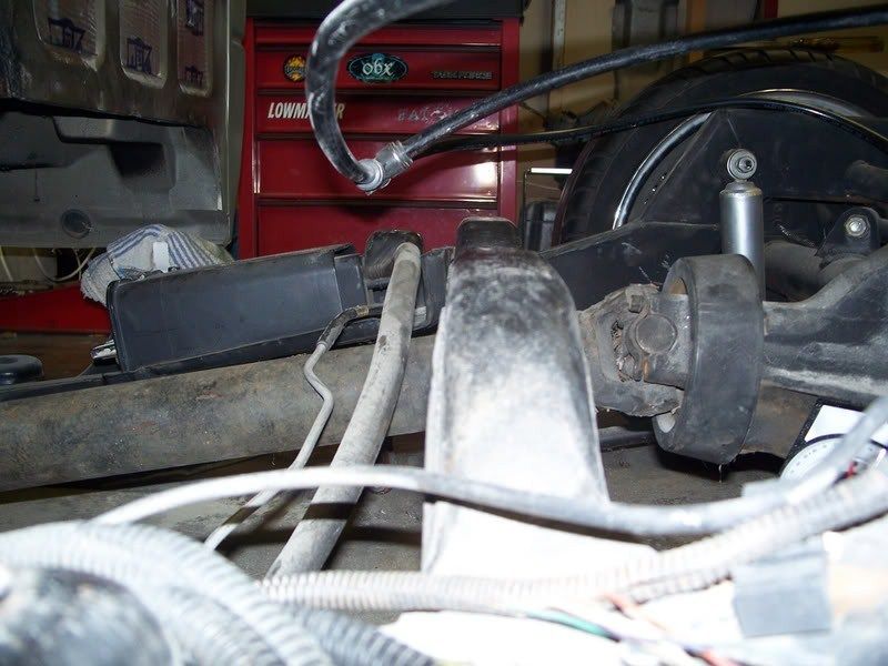

here are some other shotswith driveshaft in

You need to set the angle finder so it's parallel with the frame, not angled with the pumpkin. If it's deflected from the plane of the angle you're trying to measure, the reading will be slightly lower than the actual angle.
LaynFrame01
Yea you need to def. redo ur pinion angle that thing its gonna vibrate u out the trk like that..i usually set my angle finder on the yoke where the drive shaft bolts up and go from there.
railmaster
the "wings" on the pumpkin are parallel to the pinion shaft
this setup is four yrs old, the only thing cahnmged in the last cpl yrs is ive been doing my stockfloor bd.
driven to greenville twice, from nashville no vibration ever...

bagdb2200
Originally posted by railmaster
the "wings" on the pumpkin are parallel to the pinion shaft this setup is four yrs old, the only thing cahnmged in the last cpl yrs is ive been doing my stockfloor bd.driven to greenville twice, from nashville no vibration ever...I mean left to right, not up and down. In the pics it looks like the angle finder is angled in a bit instead of straight front to back.
