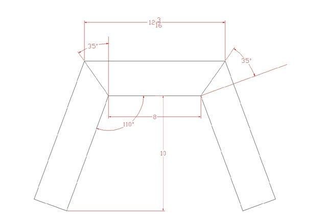

I posted this up before.
To figure out the cuts angles for your saw:Take the inside angle of your notch (in this case 110). Minus that angle from 180. (so in this case you get 70) Divide that number by 2. So in this case set the blade on your chop saw at 35 degrees.

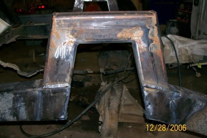

I could build 1, but im not charging him very much to bag his truck, so therefore i want to get all the bag brackets, link tabs, notch, etc.... So i can knock it out quicker. I build all my stuff, but im not on a time limit or getting paid. I know it dosnt take but a couple hrs to build one, but by the time i get my angles & cut it out i could already be putting it in.

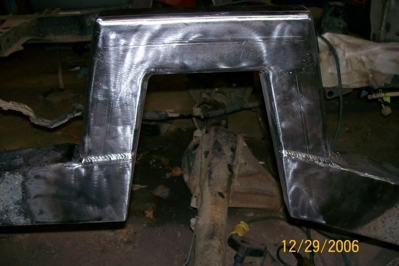

Here's the notch i built for my taco....
