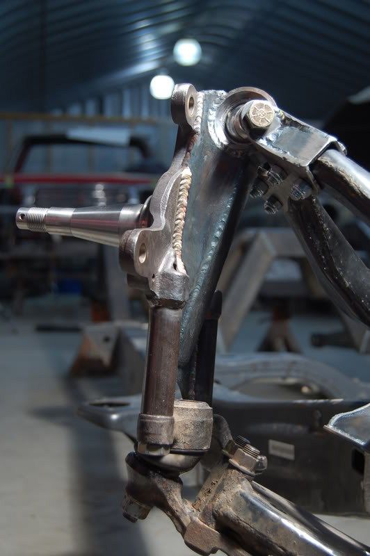

The amount of steering that you get out of a vertical uni-ball or heim set-up depends on the spherical/misalignment relationship. There is a table on the www.hm-engineering.com website. The right size upper spherical would be a 3/4" spherical with a 1/2" spacer. That would offer up to 28 deg of steering in each direction. As little as that may sound, I can assure you that it would be enough for most applications. Most of you would be forced to limit your steering because of big wheels anyhow.
Concerning yourself with the spherical/spindle interface is good. There are several ways to do it, most of which had been addressed recently in another thread. But just for good measure, this is how I have done it. One traditional style and one vertical.

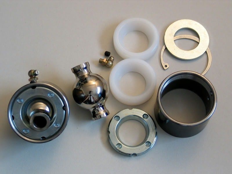

this may end up ebing a double most but i didnt see it appear the fist time so what the F....anyways biomax you are the god of the suspension forum. my machine design 2 class tonight we were learning about teflon lined bearings, pretty sweet stuff does the work so we dont when it comes time to lubercate. well i would these rebuildbale uniballs on a 4x4 site and wondered what everyone thought, kind of sucks though u need to grease em...
BioMax's avatar
BioMax
I did some stuff with Jonny-joints when they first came out and I worked with Super-pivot joints here recently, but I think those are far better quality and probably more expensive. That type of joint would work great on a trail-rig or a minitruck, but the desert trucks require a little more toughness. If someone is using these on a class 8 unlimited, Trophy Truck or class 1 car I would be interested to know how they hold up.
