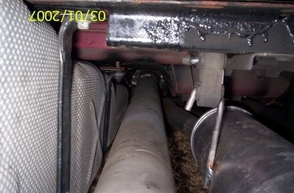

my stock fuel tank was lifted above the frame, the floor of the cab above the tank and drive shaft was raised approx 1/2". .look in my profile and you can see how the x-member above the tank was done. ill get pics of the notch later on today.
tmiit71's avatar
tmiit71
heres the best pic i can get for the raised tank and notched cab for the drive shaft

riceeter85's avatar
riceeter85
hay is there any better pics of your crossmember i dont understand that pic? thanks mike...
