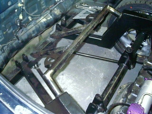

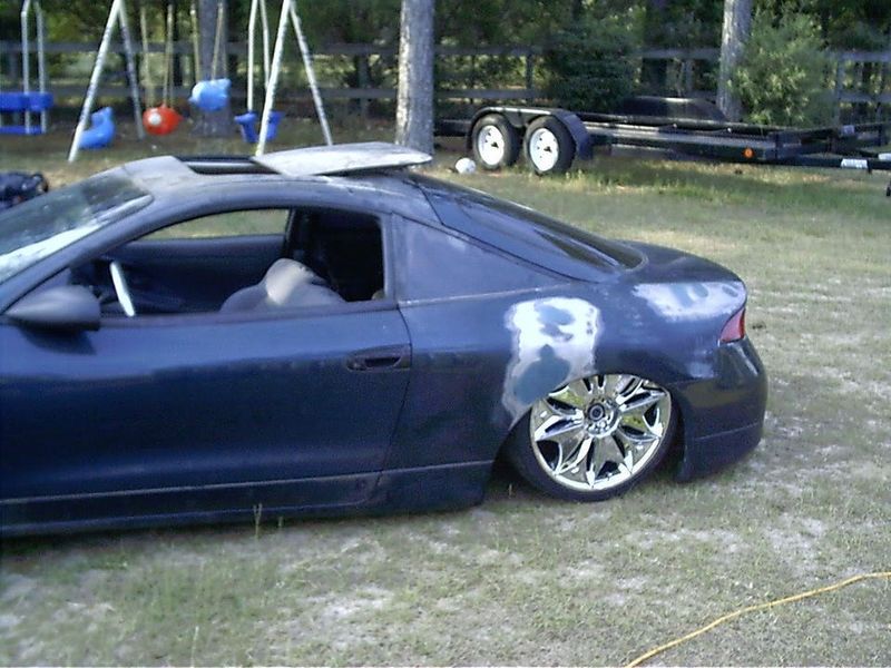

My buddy and I did an eclipse with a solid axle on 20's it is just a trailer axle i built the frame from the gas tank back with a reverse 4 link. took tome time to make it solid thought, cause everything is sheet metal basicly.
