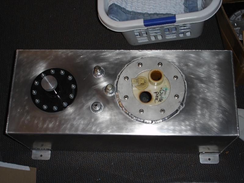

peep mine, i used a 19 gallon rci and made a lower 1/4" spacer that was drilled and tapped after it was welded on and then i drilled an upper clamping plate to hold the pump in, and it works tits.

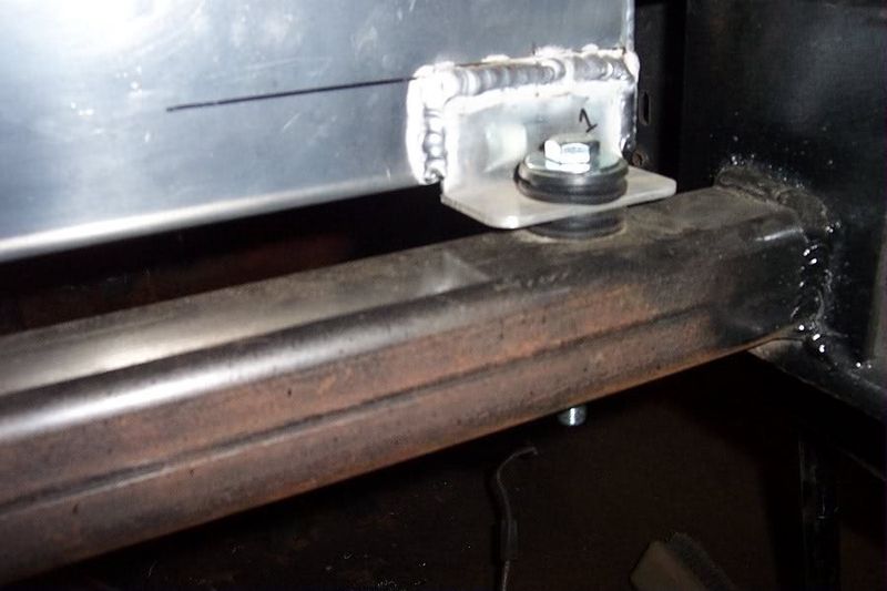

i woudl recomend welding on some beefier mounting tabs and isolating them with rubber grommits like so VV.

so the ONLY way to keep the stock gauge is to get the same level tank? where did you put the cell at fatheadjames, in the bed or in the stock location. and did you get a cell the same level or no. That a nice job Big Joe, and thanks for the pics.
