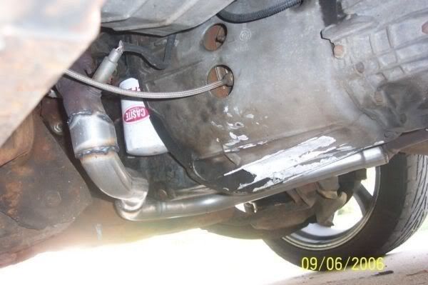

I ran mine in front of the oil pan too. It works perfect and my truck is stock floored to the doors.

i've bent 3 now, i am giving up and running true duals, with an H pipe farther down.....

If you do it yourself, make sure you don't get it too close to the tranny or any cooler lines if you have them. I don't recall the setup on those offhand but the heat can potentially ruin the transmission if things get too close.

I ran mine further back, crossed it by the yoke and tied into the pass. side.
that's what you have to do, i'm running 2&3/4 with a stock floor BD and haven't had a problem since i did it.
werd on both parts.

Hope these help
capcomfan19
i got mine done on monday... driver side goes straight under shift rod over tranny x-member then ties to the pass. side after going under the yoke.
the exhaust shop complained because its like 2" from my fuel lines above my tranny x-member. but no problems yet... i might later get some header wrap for it...
