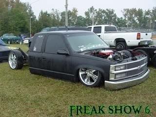

my tops are uncut , on the bottom i jus dehumped the back side of the arm and had to shorten my upper cup about half an inch
Thebutchershop's avatar
Thebutchershop
im sorry i had to trim a little lip off of the bushing end of the upper so it would go up it hit the bushing mount

i meant to say HE7 , they give you better lift, sorry bout that, the re series wouldnt work for me,they dont give as much lift, they are the same as a 2600 but work ten times better, ill never use anything else but theses bags, you dont have to cut as much out the frame either , you wont need to run shock either they ride great , i got mine from suicide doors.com , dont really no where else to gettem but they will work hope that helps, and yes as low as mine is now i lock the upper control arms out a 200 psi! and ive drug about 1/2 inch off my doors , not braggin jus lettin you no how well they will work
