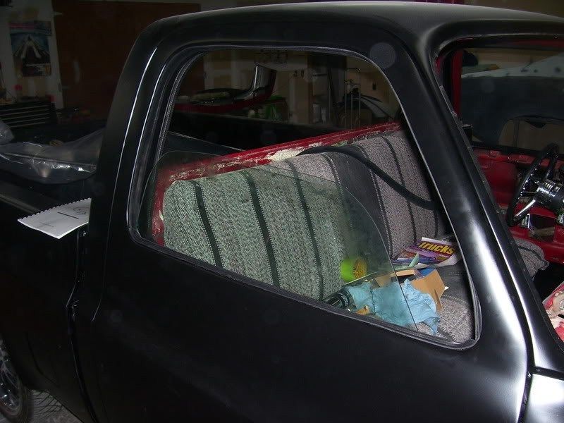

I put some of the one piece products in a 87 truck I did. they fit so bad. I took them out and had the owner of the truck send them back. I couldnt even get them all the way up in the window channel. And they were really far from the out side ruber at the bottom. about an inch or so. there also isnt enough suport at the front so with the glass half way down it just flops around.They said I could bend some stuff around and they would work better but with fresh paint I didnt want to do that. So if anayone gets these I recomend making sure they work before painting your truck. They did look killer up though...
this is as far up as I could get the pass side.
did u use the 67-72 kit if so theres ur problem. the 67-72 glass is flat ant the 73-87 has a curve to it and its harder to make a glass due to the curve but the kit is high i play on a 67-72 site and there was a guy sellin them for 699 i think that was for a holiday specail
