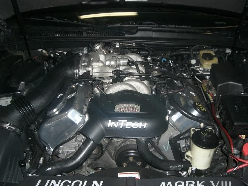

i powder coated my valve covers on my lincoln with reflective chrome from eastwood myself and its fine, i use neverdull on it and havent had a problem yet. the trick is making sure you bake it long enough, about 25 to 30 minutes at 375 . its holding up great on my motor!>http://i26.photobucket.com/albums/c106/jamies97lsc/valvecovers051.jpgdammit i dont remember how to post a pic on here
