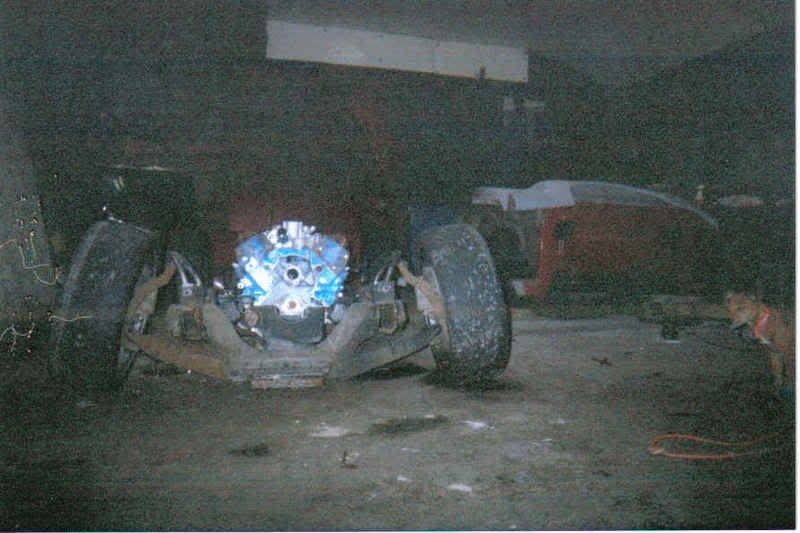

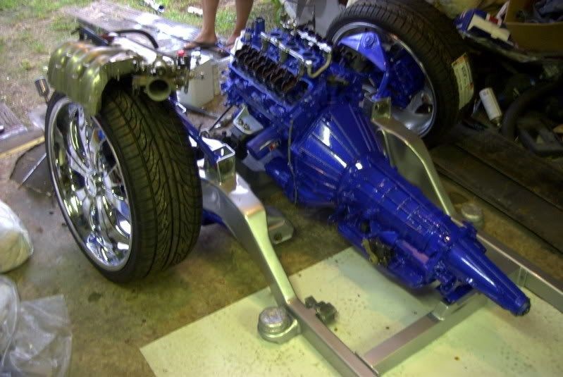

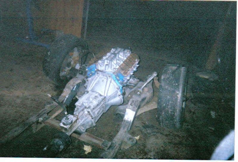

I want to see pics of your z'ed frame or maybe reworked engine crossmember, anything that helps your ranger to lay flat.
bodydrop99ranger
Iownissan's avatar
Iownissan
Edited: 11/6/2006 10:41:49 AM by Iownissan
these are his ^^

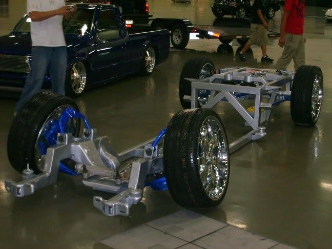

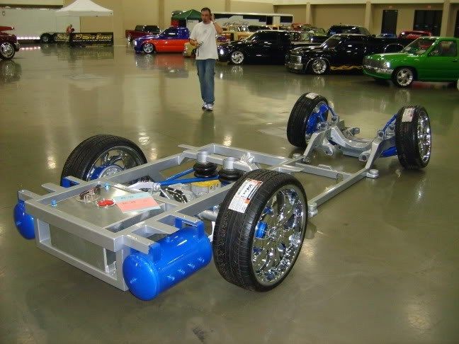

I have some pics in my profile
st Ranger's avatar
st Ranger
Thanks a lot guys.

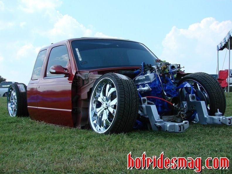

So the transmission will clear the firewall and tunnel without lowering motor mounts?
I am also putting a 5.0 so I am a little concerned about clearance. As for the hood, it can just go threw, I don't care.
msturg's avatar
msturg
It will clear the hood fine, my edc came loos a little and rubbed the bottom of my hood, so it is close but fits. The transmission clears the tunnel opening on the firewall, but the floor does need cut out for around the shifter and the back of the cab needs notched for the driveshaft.
