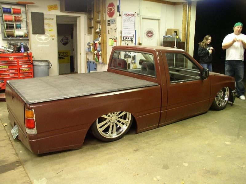

i wish i had some more recent better looking pics of my truck to post (feel free to post one if someone wants) but like i said it's bd'd a little less than 3 1/2 and my frame didn't lay as hard as it could and my frame is off the ground still by a good 1/8" or more... also 20's laying as hard as i am there should be plenty of room even for 35 or 40 series. i can't remember exactly but theres like 27 1/2 to 28" of clearance to the top of the bed and fenders for wheels.. i think some people exaggarate a little on here.
