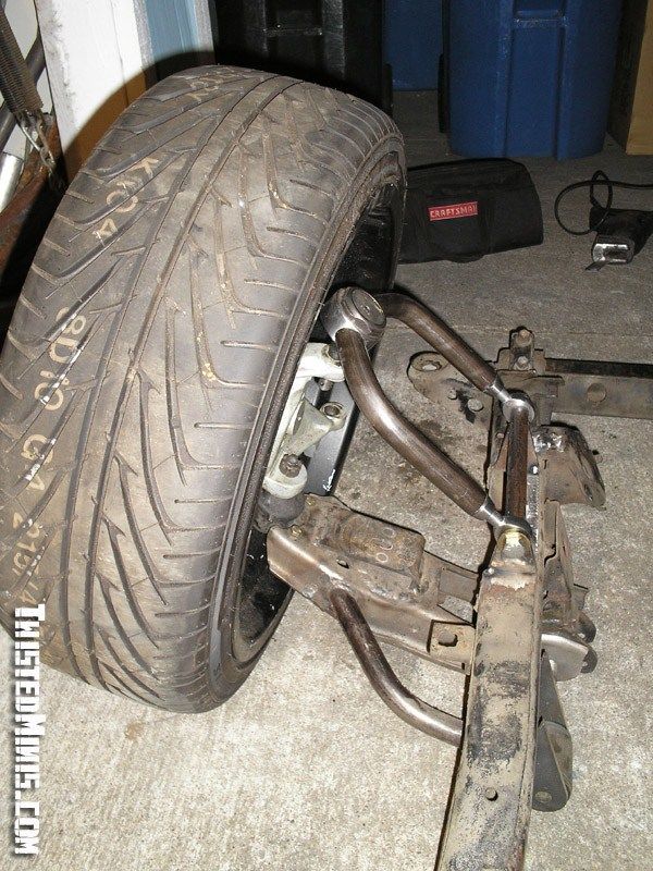

I had an idea similar to what you are thinking about doing LilPmpn. But I was going to build something with limitless travel. But I would loose the ability to make sharp turns. Not good for daily use. Ended up with just your average screw in balljoint.
sectioned88's avatar
sectioned88
So I guess I would just be best off having a regular stationary balljoint, and have adjustment for camber where the control arms meet the frame..?
TwistedMinis's avatar
TwistedMinis
Thats what I ended up doing. I couldnt find a design that I really liked that would be flawless. So I went with the tried and true design.
I'm not saying thats the way to go, just the way I went. Its still ultimately up to you.
thacru78's avatar
thacru78
Hey seth, were did you get the balljoint sleeves and the heims at. I would like to make a set of upper for my truck like that. With the screw adjustable instead of slots. Thanks
TwistedMinis
Balljoint sleeve is from Speedway Motors. I got the heims from Ballistic Fab. They are chromoly QA1 heims. They're not that bad a price. I also got the tube adapters there.
