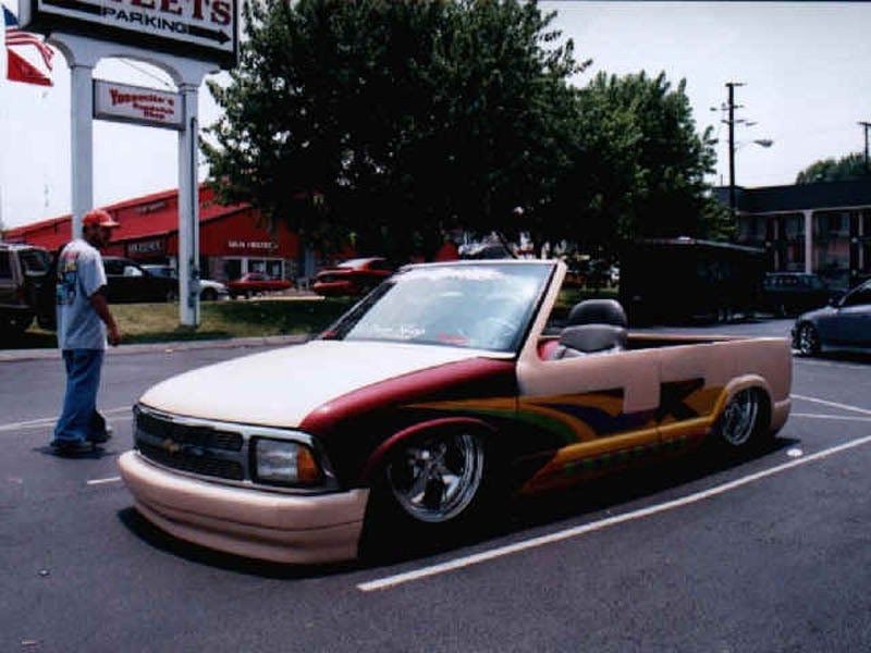

Ashton's avatar
Ashton
lunatiksblazer's avatar
lunatiksblazer
well, i dunno wat to say about that besides its different
