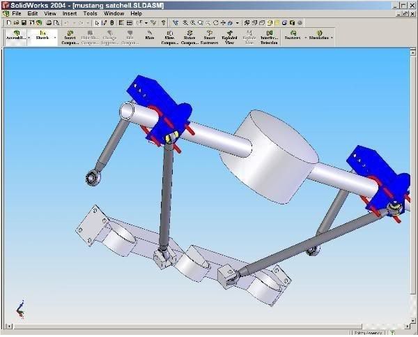

this is a Satchell link

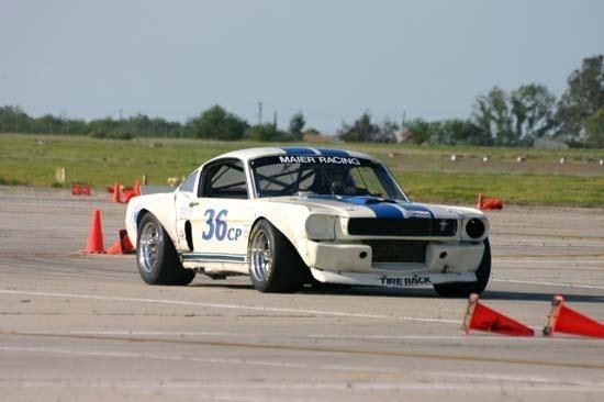

abraham what is that setup on?
1 LoWfUKn RaM's avatar
1 LoWfUKn RaM

thats awesome. i dont see any problems with a setup like that. why is it that the upper bars have to be the angled ones? lowers seems to work too.
lownism0
is the only difference in a Satchell link and a regular tri 4-link that on the Satchell link the lower bars at triangulated and the uppers are straight?
