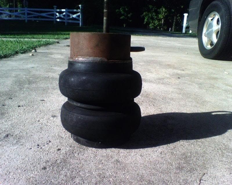

i have the sd s10 cups that had lowers, didnt change cups when i got control arms. So i need to buy taller s10 cups from suicide to utilize max lift awsome man thnx for the help. this is what i run now
