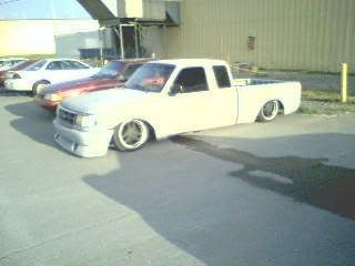

Crappy phone picture

looks like your airline is pinched on the top pic
was thinking the same thing

yea u get what bout 5 in of lift? if you would have angled those brackets mroe towards the front , youd get more lift w/ less psi. i do like how you cut the bracket instead of the frame to make them fit

I bought the truck with this setup on it, and have already blowed both front bags. The reason I posted the pics was to see if it would easier to just buy new mounts and notch the frame or try and move these mounts forward or put a yota clip in it.

i would put a yota clip in. its more but definatly worth it!
ddranged
once you clean it up if you are blowing bags because of the tires rubbing i just run steering bump stops. they work great and you still can turn plenty.

FUCK steering stops, i get full turnin radius w/ my truck at full lift. is the poor design of those bag brackets.
