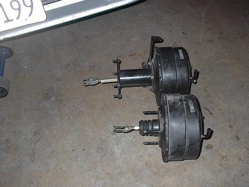

hardbody pedal assy & booster just like smcprez said..it should go in w/ lil fab work or u could go w/ an under dash assy. By switchin to the HB booster it will sit about 4" closer to the firewall bcuz it doesnt have that goofy pipe off the back of it.... now Chris u have it in black & white so hopefully u wont forget it

I went with a 300ZX booster (similar to HB) that looks identical to the 720 booster without the extension tube.

Had to relocate the Clutch M/C in order for it to clear the booster now.
