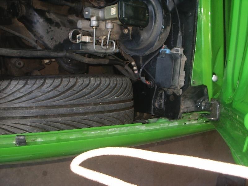

you can take it apart and push the whole unit inside and just make a filler plate with enough room for the wireing harnes to come out.
bdroppeddak's avatar
bdroppeddak
i cut mine, lengthened all the wires, then relocated the mounting plate to the side of the cab right behind the wheel. that way the harness bolts back like stock incase i need to take it off again.
