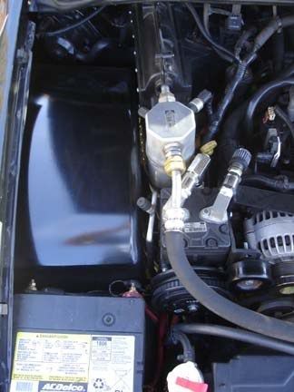

I only had to lengthen the wires from the a/c everything else was long enough...yes u have to bleed the lines, and get new lines made...and when u get it all back together you will have to get someone to pump the brakes and there is a bleeder valve on each one of the calipers and wheel cylinders (in the drums, you probably know bout that... it takes forever...

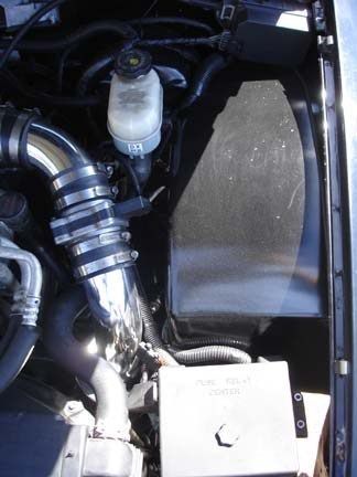

how did you get your blower twisted like that? Did it take any modding of the box, you have to build a new one or what? and where do i bleed the brake fluid from? Just take off the lines from the master, or the abs?

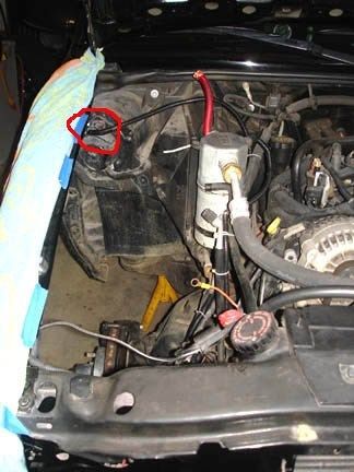

so the fusebox wires were long enough?
jumbo's avatar
jumbo
and the computer wires? What wires from the ac did you have to lengthen, what i mean is, where are they?

i didnt make the box, The Little Shop of Horrors did... but yes it is a complete new box, u can see the screws that attach it to the stock evaporater core...
to get the fluid out just open up the bleeder valves when u have pressure in the brake lines... u have to have a bleeder wrentch too... but u could ask around im sure there is another way to do it thats easier...

there was about 12 wires on the fuse panel that had to be lengthen... there is a wireing harness coming from the frame those are the only ones i had to lengthen...
thats the only wires i had to lengthen from the computer...
