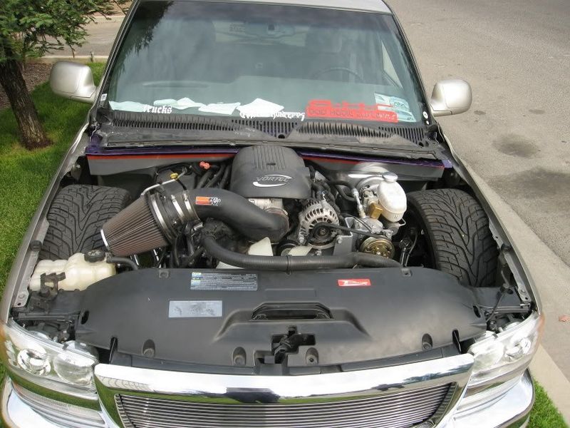

I used an inline fill on mine to. Got it at Napa for like 8 bucks. Then I used a universal overflow tank that was drasticly smaller and just remounted it wherever is easiest.
SOINSANE
^^that all sounds good but what about the lower hose leading to the water pump,1" hose which is T'd to heater core?
MF
Master Fabber
Plug it off that is where the coolant use to fill into.
03on22s's avatar
03on22s
I found another hose that was realy close to the bottom that didn't have a T. I just took the stock one into NAPA and they let me dig through what they had.

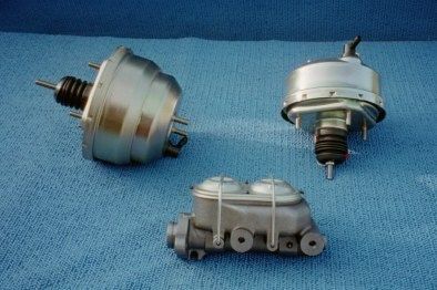

what kind of brake booster do you have?
bagsand20s
Pancho's avatar
Pancho
TOP LEFT
