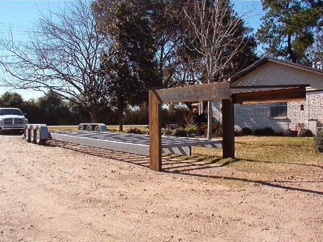

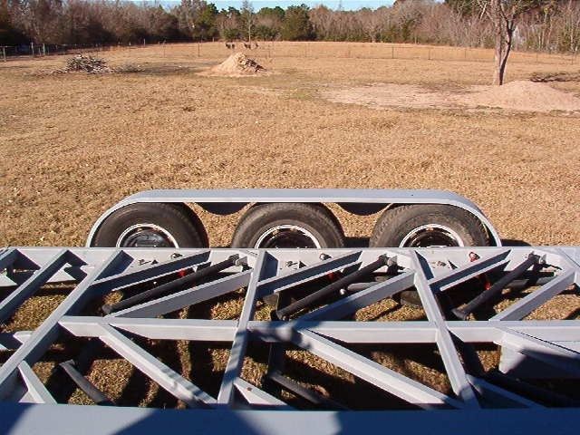

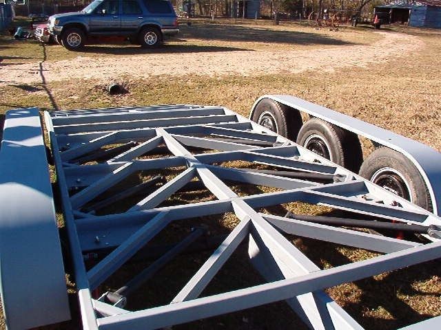

baggeddogs is building one to pull behind his ram 3500, it is the one with 3 axles. here is the link and some pics..
Http://www.streetsourcemag.com/Profile.aspx?ProfileID=37804
he has 3 4 links on that thing.. it's gonna be a gooseneck..

yeah thats my junk! LOL I hope to have it done real soon, didnt quite make it to gatordrag like I wanted but hey, its better to make money then spend it right? When I worked at Ekstensive we did a 20 ft car hauler, look on there web site it should have pics of that thing...

Mark- why did u go with 4 links instead of 2 links? Figured 2 links would work fine since you don't have to worry about pinion angle, unless there is somthing i'm missing.

I did the 4 links insted of the 2 links because I used 4" drop axles, meaning that the 2 links that would of pushed the wheels about 4" out of the center of the wheel wells and it would of looked like crap... If I wouldnt of used the drop axles I would of just 2 linked it... If you have any questions just ask and I will help you out any way I can!!!
