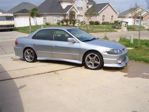

I found a NICE looking accord, '99 4 door.. but it's $6,500 a little high.. but maybe if I sold the tbird and saved a little, I could get a loan for something close to that price range if not cheaper for one a little older/less small mods already done to it.
Here's the pic of it though,

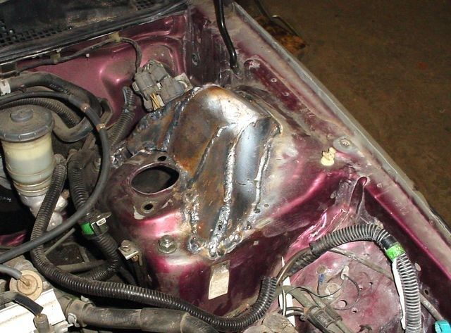

im talkin with stock braketry.... just cuttin the strut towers.... ur not goin muc lowere then mine is in the front without doin some modification to the bottom side of the car cuz the oil pan and tranny pan sat an 1/8th inch off the ground on mine.... plus the tires hit the firewall and in the back u can just make smaller brakets.

the strut towers on my car are just raised.....oil pan is very close to laying...

Check my profile there's both pics of it on just cylinders and pics of it cut and bagged. In the pics of it on just cylinders the only thing I cut was the plastic inner liner and the pinch weld in the top of the wheel well. I just cut it into sections and beat it flat, because it was cutting into the tires.
