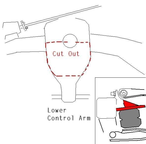

If your not going to use the BallJoints You should try hitting them out on top of the stud with a small sledgehammer. A good brass or lead sledge is good because it won't mar the hell out of it. I used to use a fork but they tend to bust open the balljoint rubber. The best way to bag your Toyota up front is to cut out that part in the RedI drew it up real quick. hope that helps.
streetsweeper1
Ohh, and don't forget to reinforce the part you cut out. Basicly fill the gap between the boxed frame and the lower control arm subframe with a piece of 1/4" (use a piece of posterboard for a template.).

Kyle, that pic is AWESOME
saved it in my install pic folder, since its pretty much exact same spot i cut and sometimes my real pics dont show how high as easy.

that pic is perfect thanks
