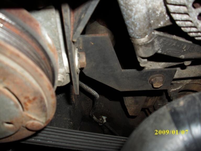

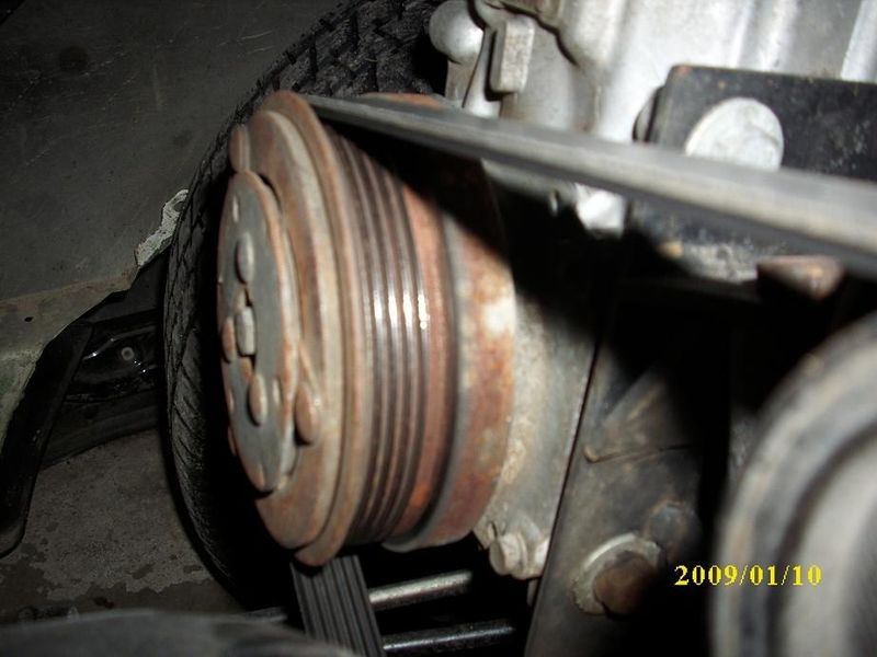

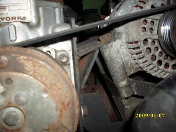

framedranger's avatar
framedranger
I have one on my ranger ..I will post a pic later on today

shavenotbagged
I got one on my ranger its very simple actually , I made a 90 degree bracket so it bolts to the side of the compressor and than to top bolts of my alternator. and what i did after that since it will rattle around a little bit i made a tab towards the bottom to go from the bracket itself to the part of the block that holds on the alternator., I dont no how to post picks  but i have the file on my computer

--------------------------------------------- Originally posted by killswitchmsi I got one on my ranger its very simple actually , I made a 90 degree bracket so it bolts to the side of the compressor and than to top bolts of my alternator. and what i did after that since it will rattle around a little bit i made a tab towards the bottom to go from the bracket itself to the part of the block that holds on the alternator., I dont no how to post picks  but i have the file on my computer --------------------------------------------- thats pretty much the same thing i did. I had to relocate the top radiator hose and  the air cleaner. I will post some pics tonight around 5pm
