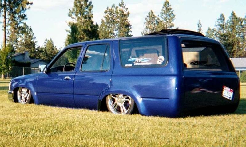

my scanner sucks so i don't have any pics of my old one on the computer, but looking through the profiles, here's someone who did the same thing almost. with the pickup roll pan though, you'll still be able to use the gate.
corey0814's avatar
corey0814
btw his name is ivrunninglow but that's the only pic of the back. i have a ton of pics of mine, so whenever i buy that new scanner/printer (sometime soon) i'll post a bunch of good ones. good luck!

ivrunninglow
Thats what I did.....bedsides and a cut down rollpan.
