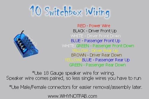

outkastyota
iv searched an i couldnt find anything.
im wantin to mount 2 switches for F,B. an just run the wiring off my 10 switch.so can someone tell me or have a diagram on which colors go to which?
whynotfab's avatar
whynotfab
Colors are known to be backwards in some cases though.. so it's always good to have a test light handy, etc. Are you using the 10 switchbox as well as the 2 mounted switches, or just using the wire and ditching the box?
outkastyota
yeah ima be usin both of em. but just have the front back switches..but thanks man
whynotfab's avatar
whynotfab
Just splice into the wires right at your valves then, should be pretty easy.
