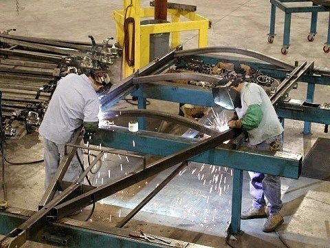

this is the frame jig i use at work
chunky_thunder's avatar
chunky_thunder
it is for boat trailers but it has been known to build the begining of a truck frame that is me on the left

one thing you will want to do is work in some adjustabilty so u can level it off.
