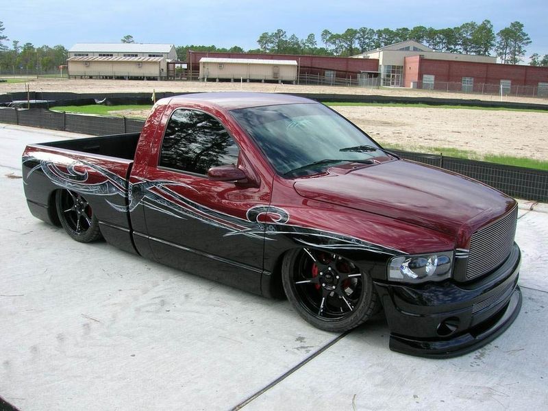

I use em all the time and i love em, u just gotta get em reduced right and they can work wonders. i didn't like em at first either, u just gotta get used to em. oh ya, and make sure you use intercoat clear over em before u do any tapin... a shop i was doin work for learned the hard way on that, fucked up half my work....but this ended up turning out nicely, all the graphics on this thing were done in em..
