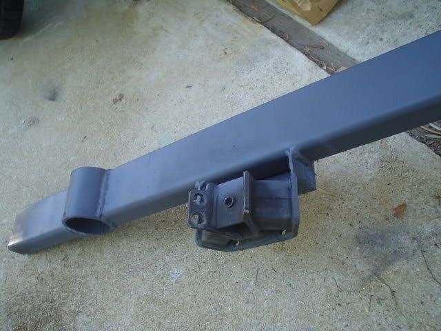

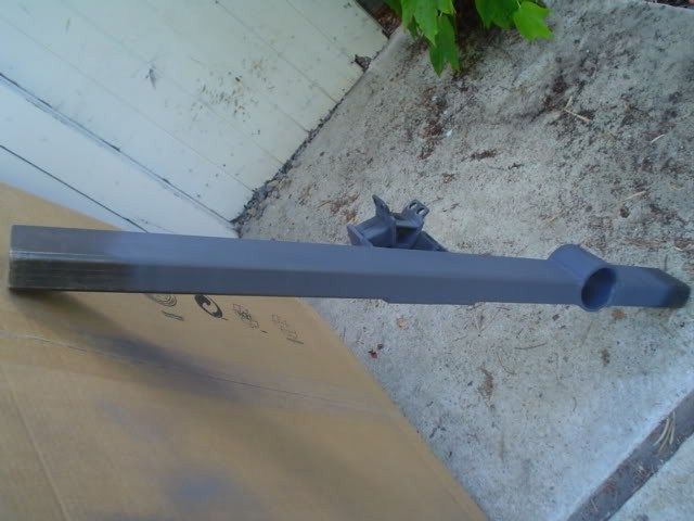

I used a piece of 2x3 with some tubing welded in to run the exhaust through. i suppose u could always do like a c-notch type thing in it and just have a U shaped cutout to run the exhaust under it.

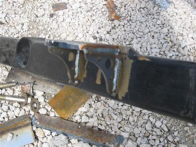

here is the best pic i can find.

my exhaust runs thru my tranny crossmember and i feel more heat from the trans than the exhaust thru the floor.
