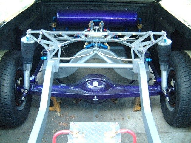

ive searched around the forums cuz i remember this question being asked before, but i found nothing.would it matter if on a triangulated 4-link i ran the upper bars straight and lower bars angled? itll be a SD.com link so its hella beefy.

No difference. You'd be fine.

yup no difference

most race cars that run triangulated 4 links run them like that.

It will be fine.

and just loading your vehicle with uneccessary weight, look at a racecar, their bars will be 1" or less in diameter, and they push 400-1200hp+.

i built my 4-link and my bags are mounted on a 1.5" square with 1/4" wall....

hey Bryan, are you referring to Jeff's yota? if so, he showed me pics last night and it looks great so far, i like the idea of doing it different like that. only thing i asked him about since I personally was unsure, is how close the upper/straight bars are to each other. keep us updated with pics
