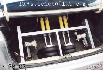

i start with the car layed out, fill the hose attached to the cylinder at the wheel completly... then extend the cylinder at the bag (i used 2 at the bag) & fill unil oil starts to come out of cylinder, connect hose & put a little air presure in the bag. then loosen hose to bleed. it will also help you level out yhe setup

its basicly a regular hydro with airbags pushing a cylender inthe trunk full of fluid and forcing the fluid to the cylenders at the wheels. 2 cylenders per wheel, one is extended and other is pushed in with the line full of oil. if you force onein the other gos out. you fill the airbag to force the cylender in trunk closed and that in ture forces the cylender at the wheel up.relase air bag presure to make the cylender in the trunk extended again (laying out the car)

i have check valves, so when the system needs fluid i just hook up the hydraulic pump and bump it a few times. takes less than 5 minutes
