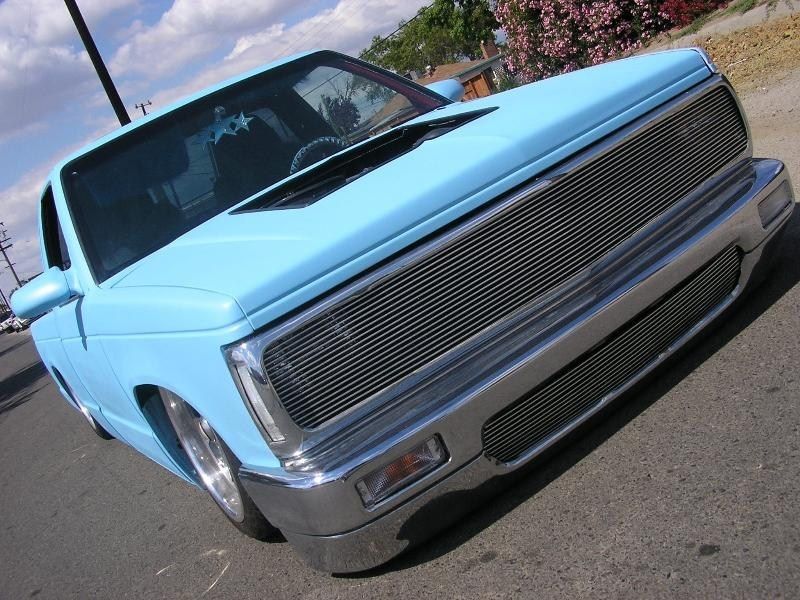

Here is a pic with my old bumper on it...

THanks, I've seen the light blue primer truck before. Can ya get the bumpers painted?

the first truck is running a 92-95 2wd valance (outward curve at bottom like 4x)
the second one thats chrome is 89-91 2wd
valncs (bottom rolls under smooth)
the bumpers are the same from 89-95
if you were to reun 4x you would go with 92-95 model since earlier is a 3piece bumper
also the first truck is running stock fender and second on is cut so bumper can be recessed to match fener well opening
running 4x bumper looks funny but will wrap around fender with out cutting
also 4x bumper dips at center
the 2wd matches better with body and hangs level with body were 4x is alittle taller
