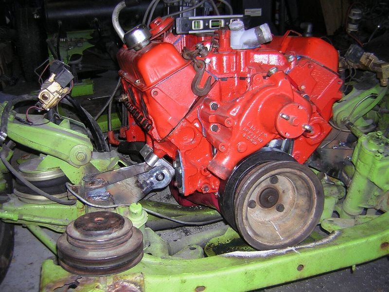

im trying to see pics of 88-95 pups layed out in the front i wanna see how they set up their mounts no pics with drop spindels just stock components layed out

ive looked into your arms but im trying to get my front to lay out before oct 20th and i know byc builds things in shifts like nissan arms for a while chevy arms for a while and i didnt know if you had any isuzu arms built and laying around also id like to see a pic of them mounted so i can see what needs to be welded where to figure if its gonna be cheaper to get your arms or just have some one redo my lower brackets

baggedizulow92
dont use a bottom bracket. just bolt your bags to the bottom control arms by drilling a hole in the top and putting a hole just big enough in the bottom to get to it with a socket and rachet

i did what he said on mine except i have hte airlift holes so i have two holds on bottom so there is a plate with a bolt in the middle of it and that is what the bag bolts too and i lay frameBy the way it is an 87 isuzu with an 89 front clip off an isuzu so its the years you want later

i dont have airlfit baggs i got firestone 2500's so i dont know if bolting it right to the controlarms is gonna be safe

it is the same concept as mine except the firestone bags only have one bolt in the bottom unlike my airlift bags
