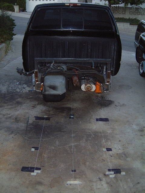

periportfd
Buy some cheap bottle jacks from Harbor Freight, the ones with the screw adjustable seat. Bottom the jacks out and use the screw to level your truck (don't use the pump, you want a steady surface) Then use a plumb bob and string to locate all the bed mount holes, width and height of all your reference points and scribe it on the ground next to your marks. Doesn't matter if the surface is uneven as long as you never move the truck till it's done. Then start building your frame design making sure it hits all of your important location points. I put 4 under the frame section I wasn't going to cut up and built it all in the air, relying on the measurements I took.
