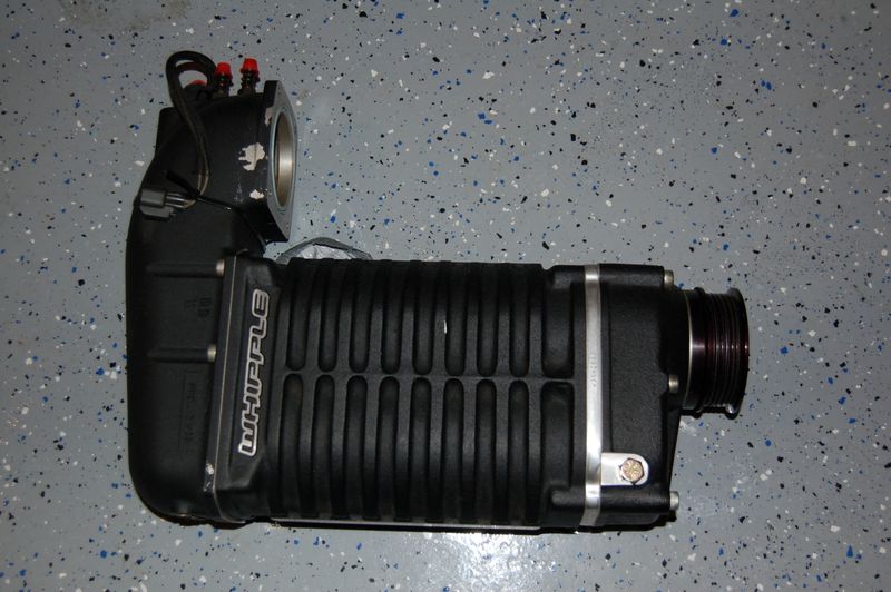

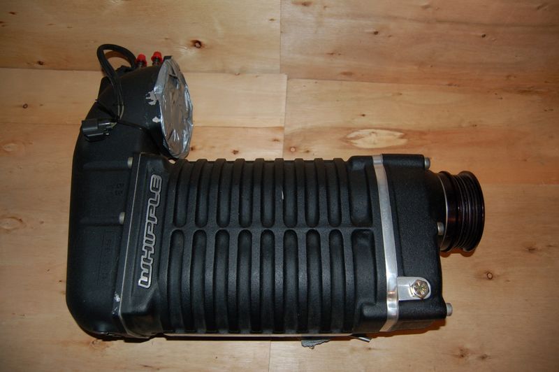

After a couple months of searching, I was able to locate a pretty complete looking kit. The owner even had a copy of the instructions! From what I'm told, I'm actually the third owner of this kit but the second owner never got a chance to install it.
I actually had the kit for a few months before I got around to installing it, this truck is my daily driver and my backup vehicles needed some work along with the house yada yada yada.
On to pictures of the parts!

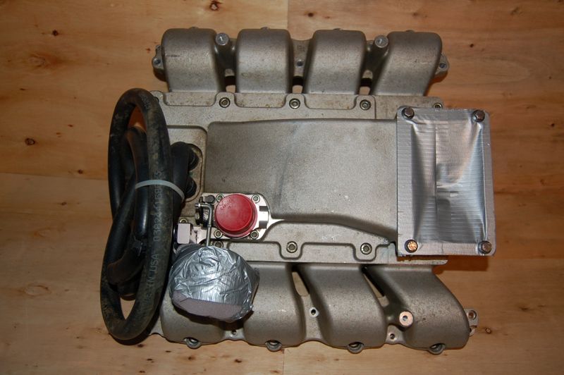

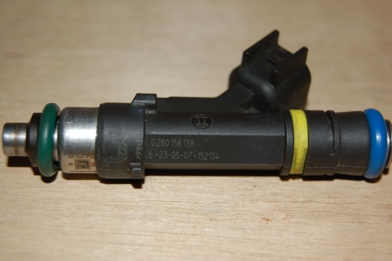

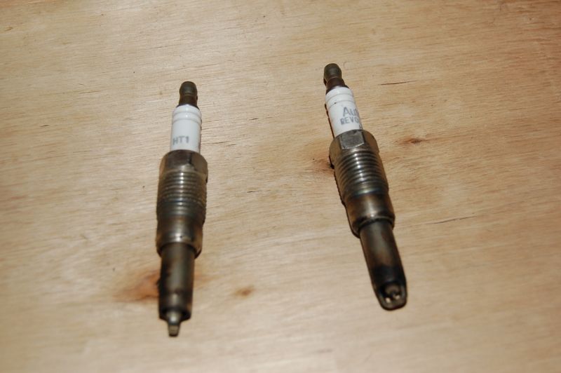

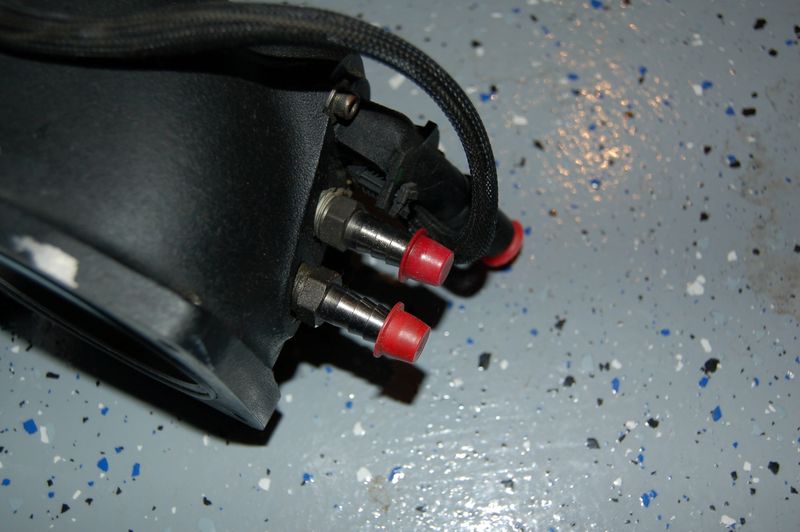

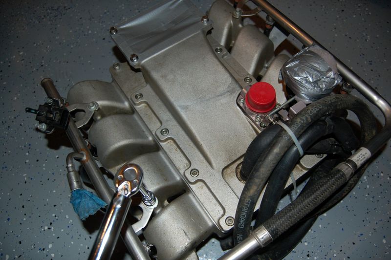

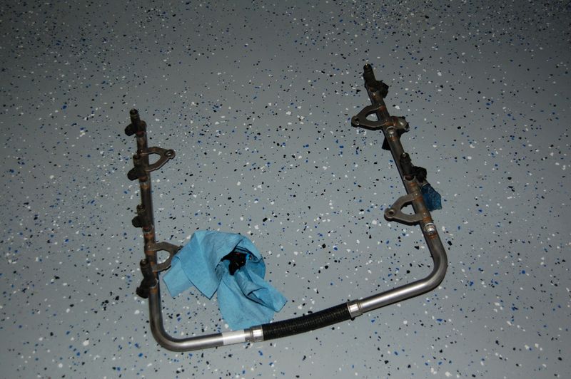

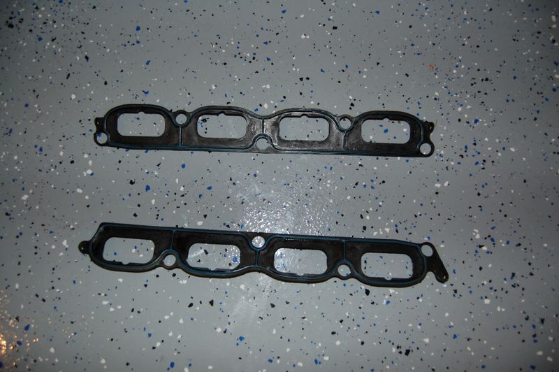

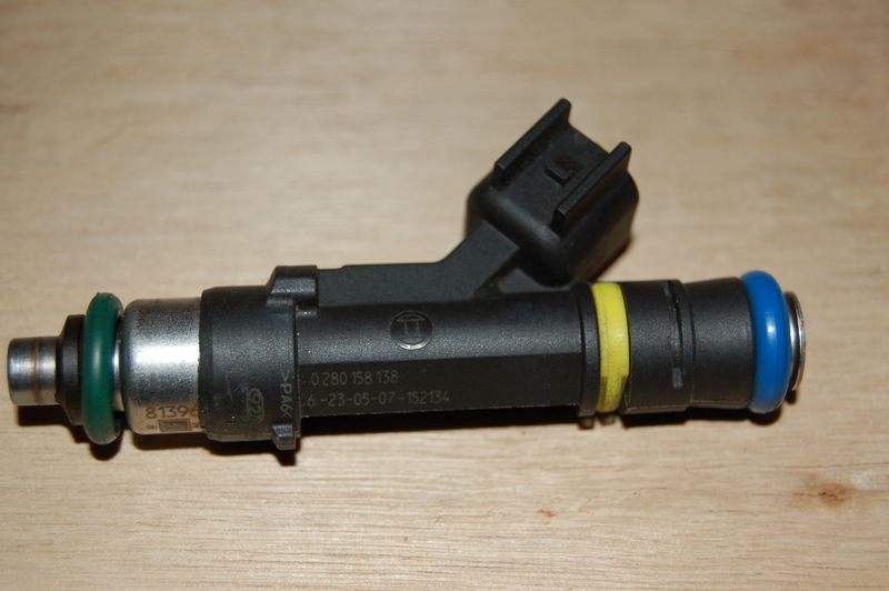

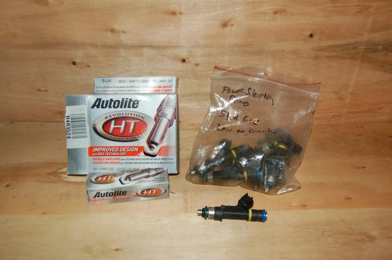

It came with used spark plugs and injectors. The included injectors have 4 holes in the tip instead of 2 with the factory injectors. I was unable to identify the weight of the included injectors, Whipple said factory injectors are ok for the 2007 model year so I decided to use the factory injectors for now.
more photos

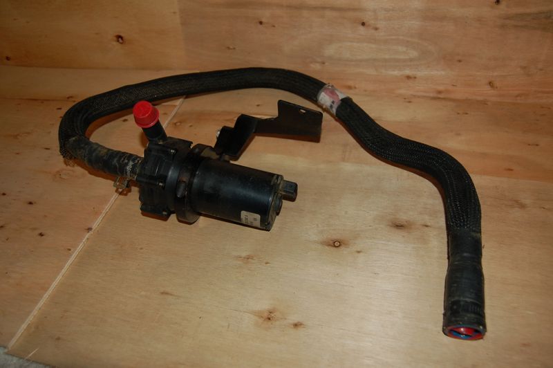

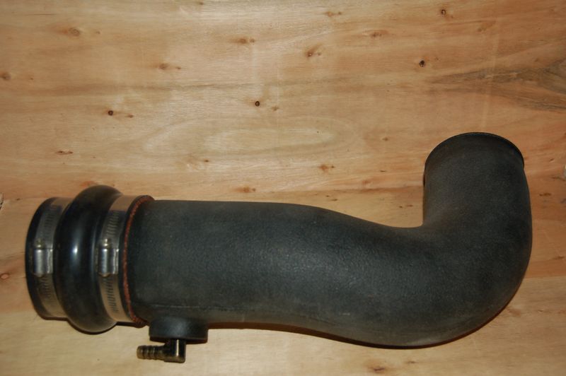

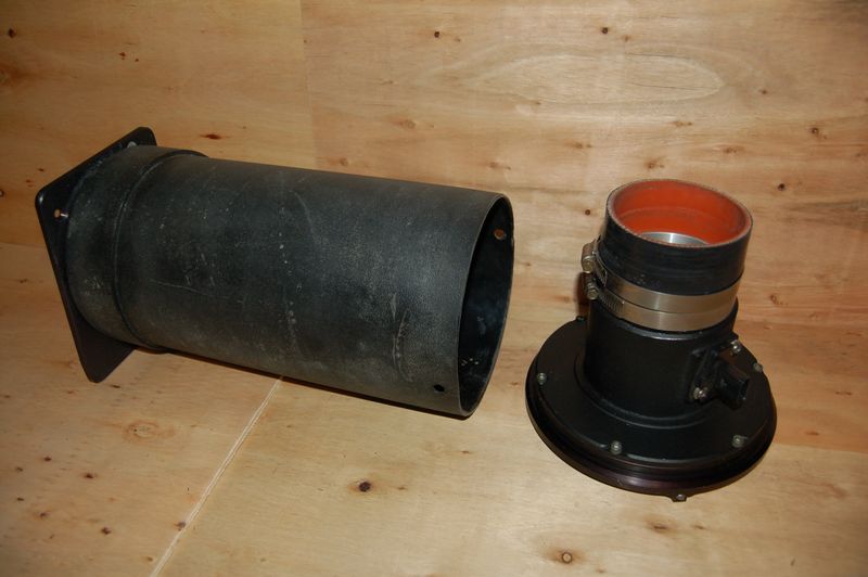

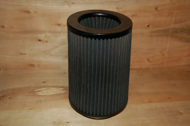

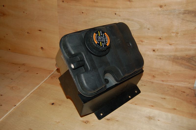

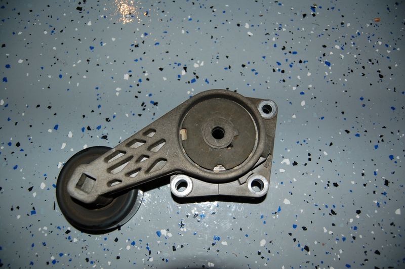

New intake, filter, and inter cooler reservoir tank!

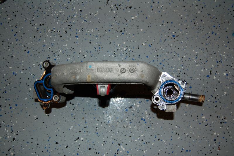

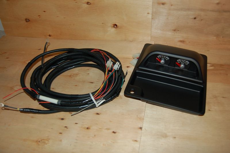

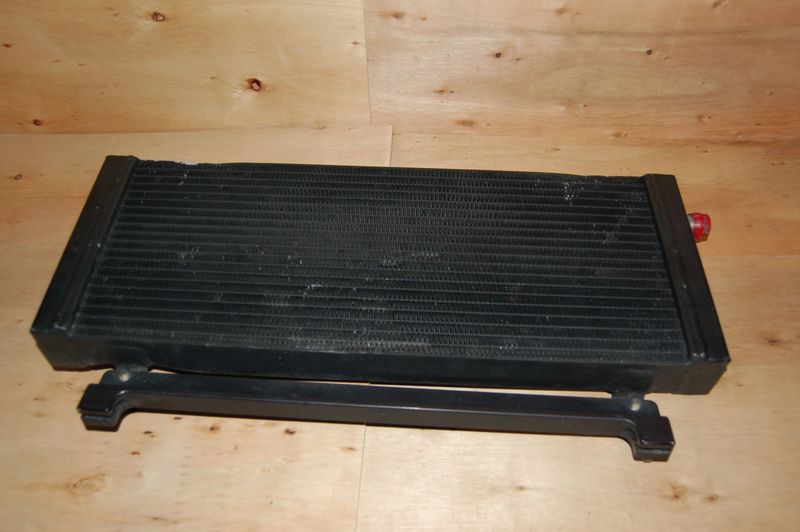

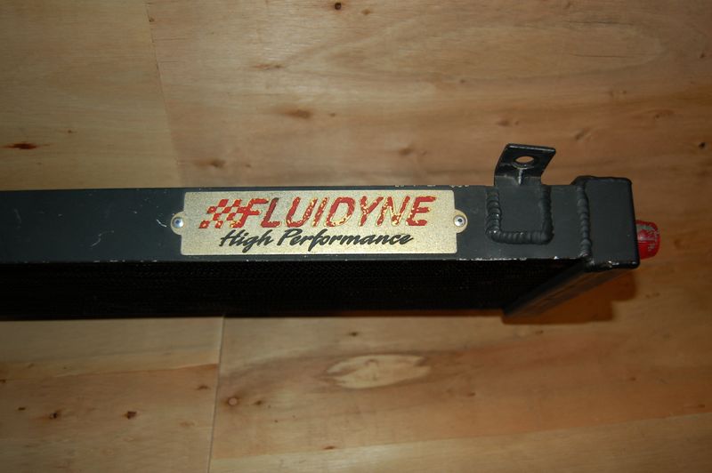

Misc. hoses and inter cooler heat exchanger.

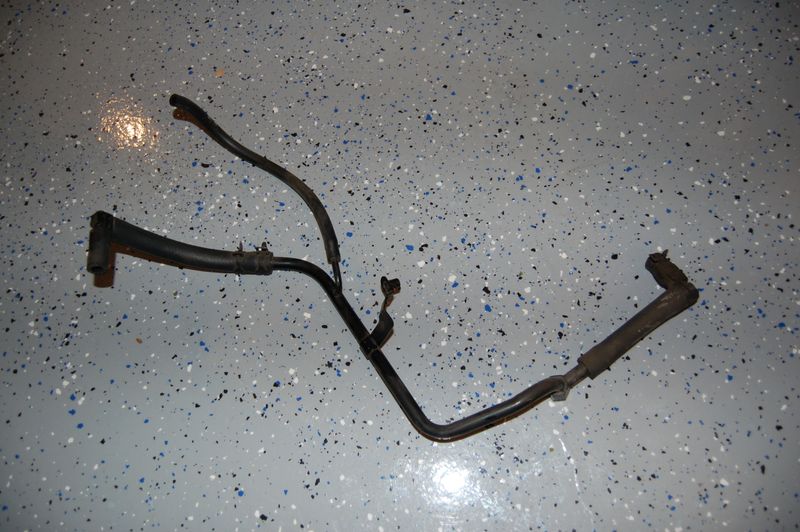

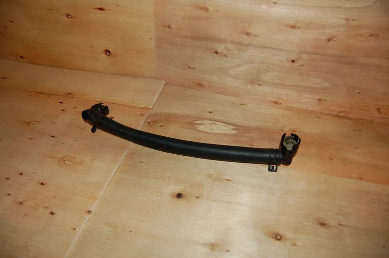

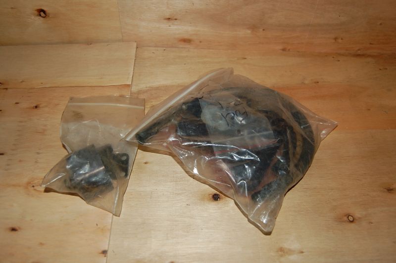

More hoses etc
more photos
