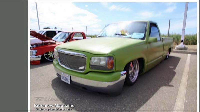

The parts at your dealer will work 100% and are actually better than the kits being sold in the mags. The dealer headlights wont turn yellow in a years time. The mags will be a little cheaper (obviously) but you get what you paid for. Youll need the fenders, hood, lights, bumper, and core support.
simple-pleasurez's avatar
simple-pleasurez
you dont need the core support. mine bolted to my stock. everything was bolt on except my bumper. i didnt like the way it sat stock so i welded it where i wanted it. but the stock escalade bumper will work no problems.
