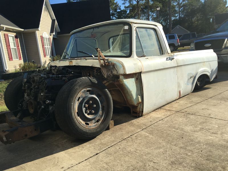

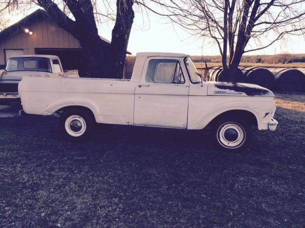

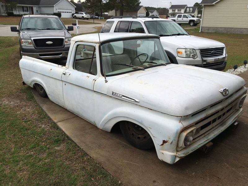

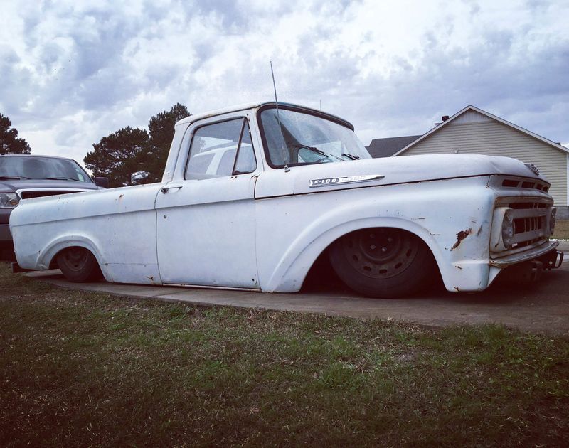

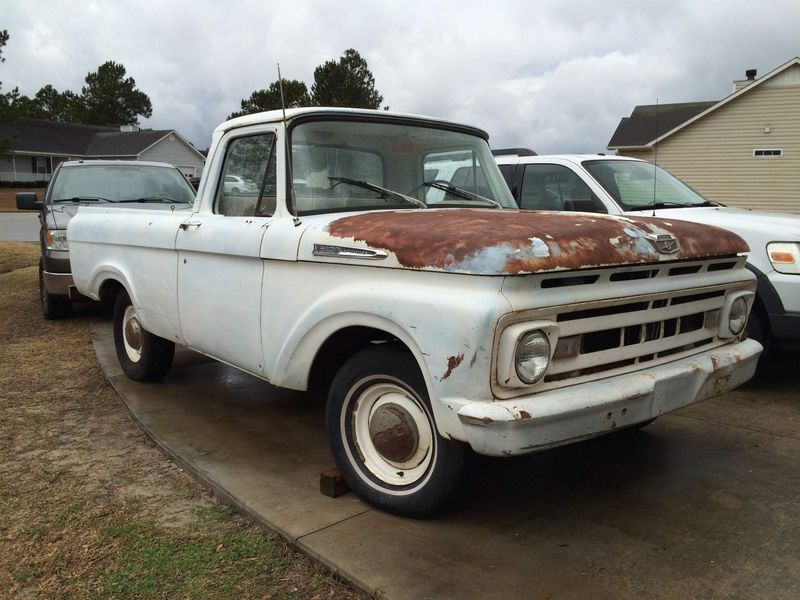

The first pic is from the ad and the second one is sitting in my driveway.

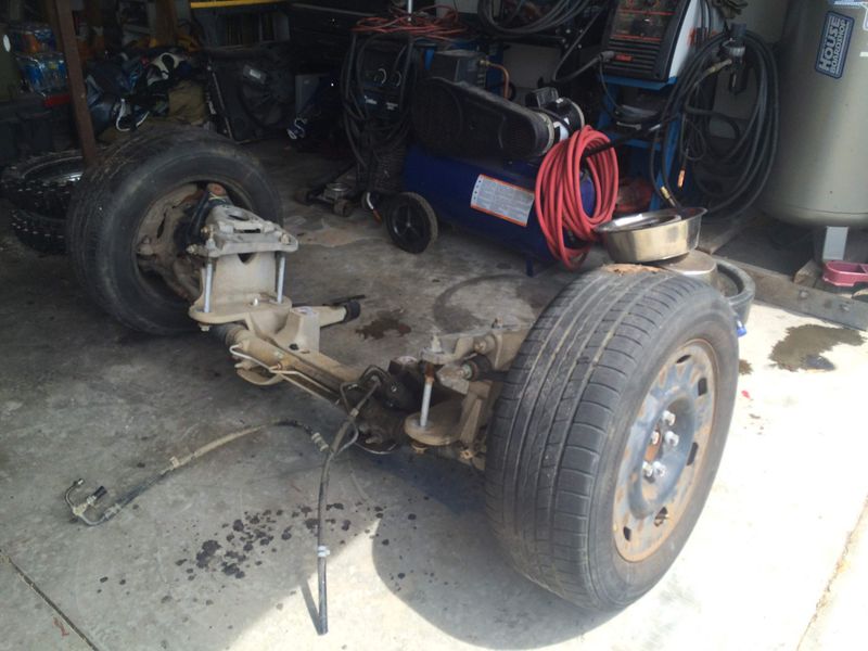

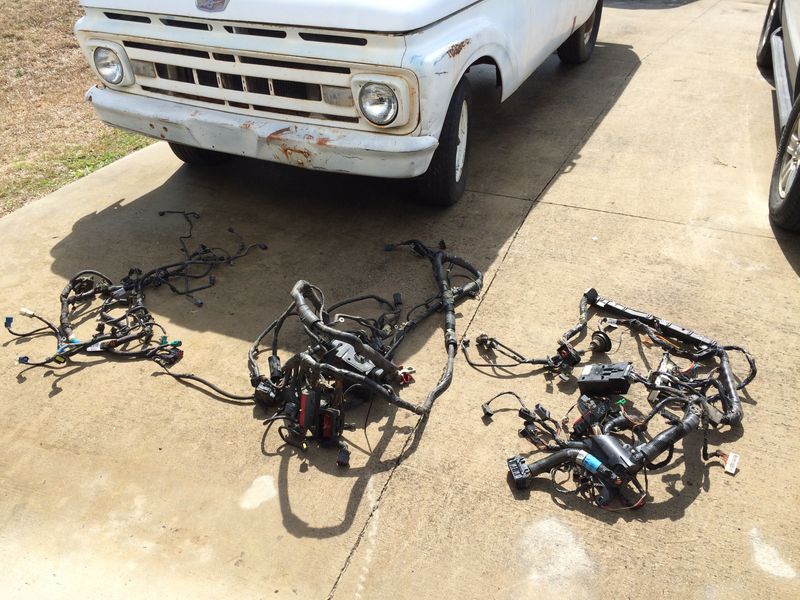

I don't have any pics of the donor car, but here's the pile of parts from the tear down. Everything is from a 2003 Grand Marquis that I picked up for $800, (with a bad transmission). That wiring harness looks like so much fun.

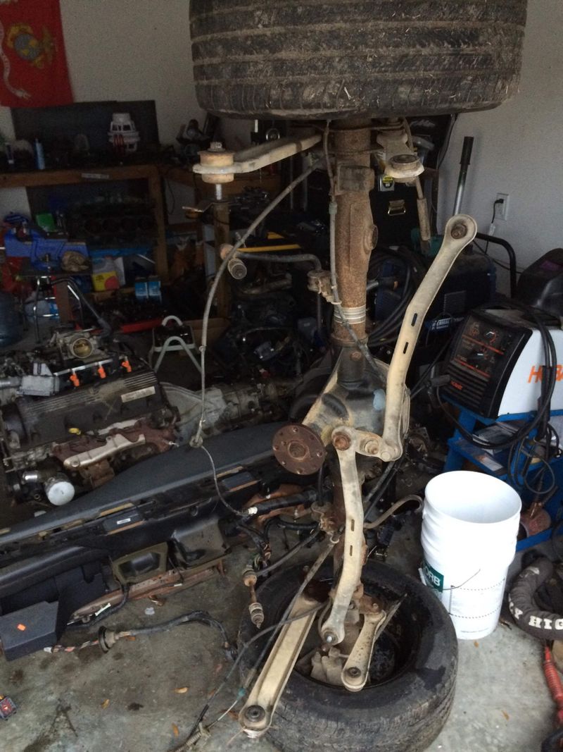

Wiring harness

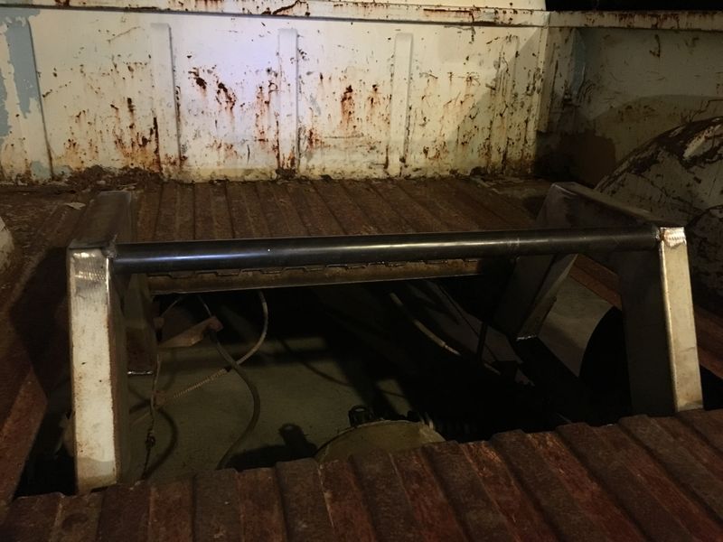

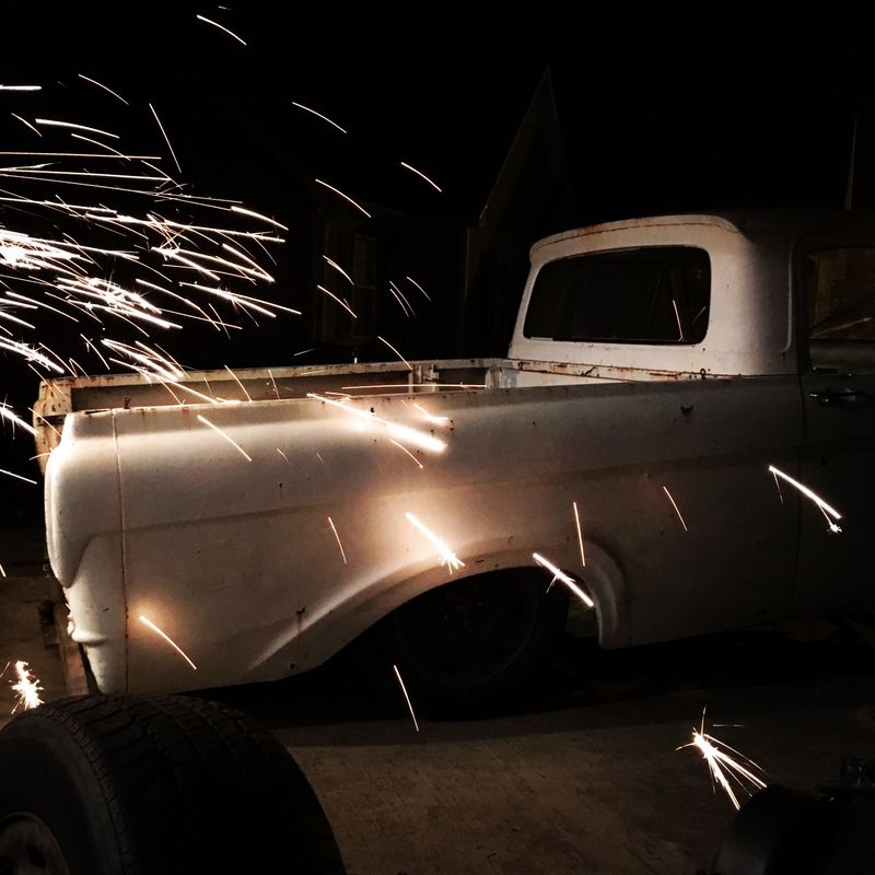

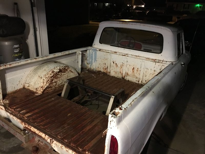

After I built the front bag mounts, (sorry no pics), I made the notch for the rear. It looks big, but the frame doesn't kick up much behind the cab plus I wanted to go a little bigger in case I want to throw big wheels on the truck.

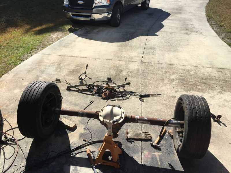

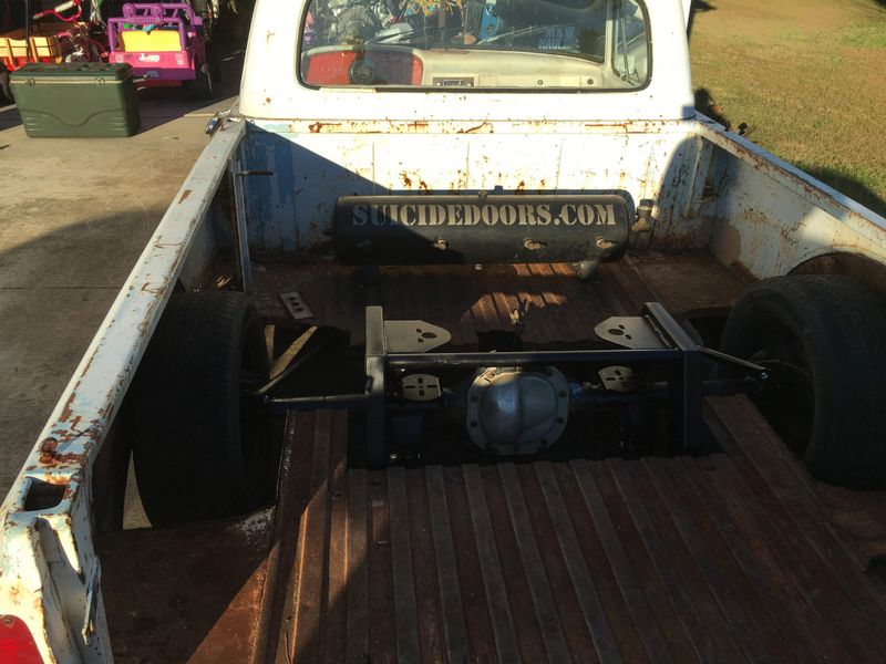

After I installed the notch I put the 4 link in. The Grand Marquis rear end was a pain in the ass to clean up with all the stock brackets. I went with a triangulated 4link and bags over the axle for simplicity. I may change it up later, as I'd prefer a parallel 4 link and watts link setup.

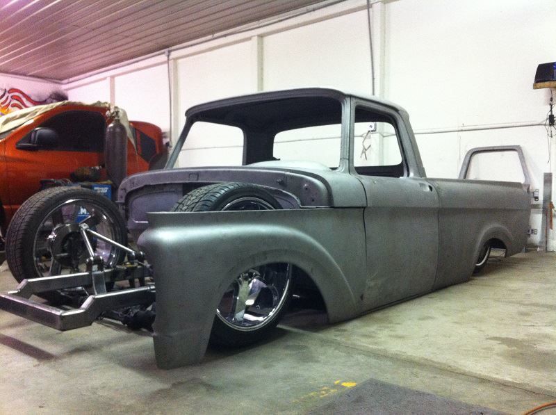

The front was pretty simple as the CV crossmember just bolts on with all the control arms in place already. I should've taken more pics, during the process, oh well. Once the crossmember was in place and bolted up, I had to do a 3" Z for the body/frame to lay, (no body drop required).
theinternetkid's avatar
theinternetkid

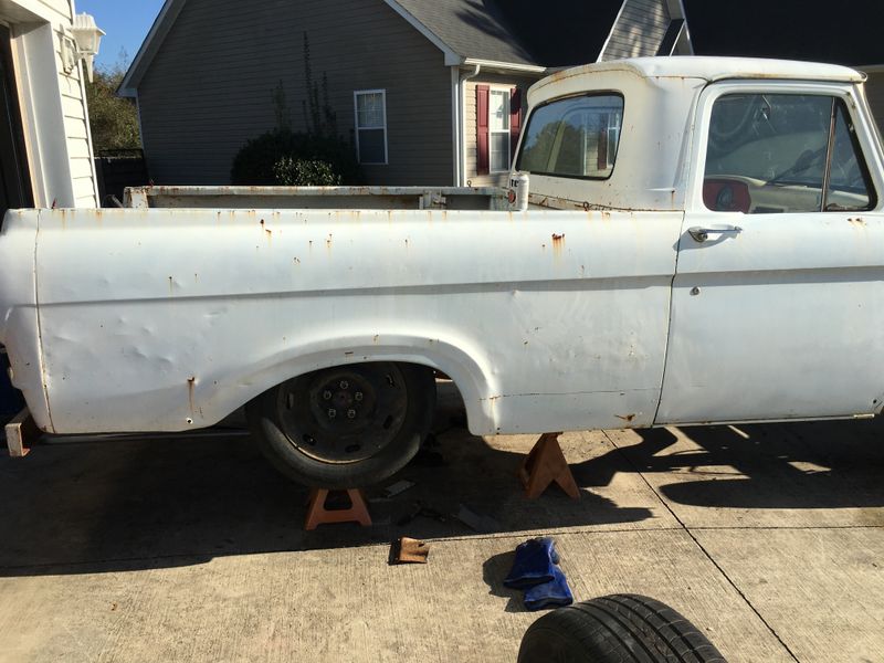

Here's the truck with the front clip mocked up (not bolted down). I threw in the pic of the stock set up because I forgot to put it in earlier. Leaf springs and a straight axle up front.
