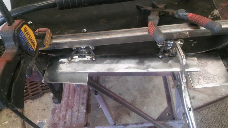

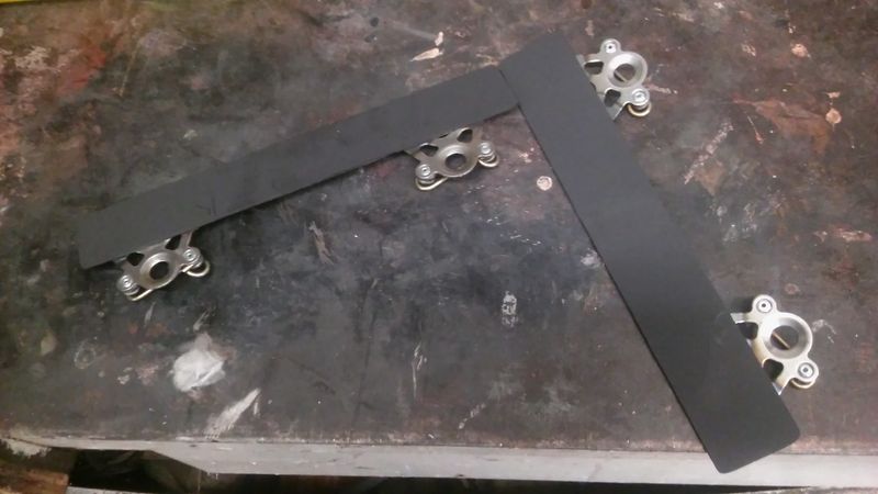

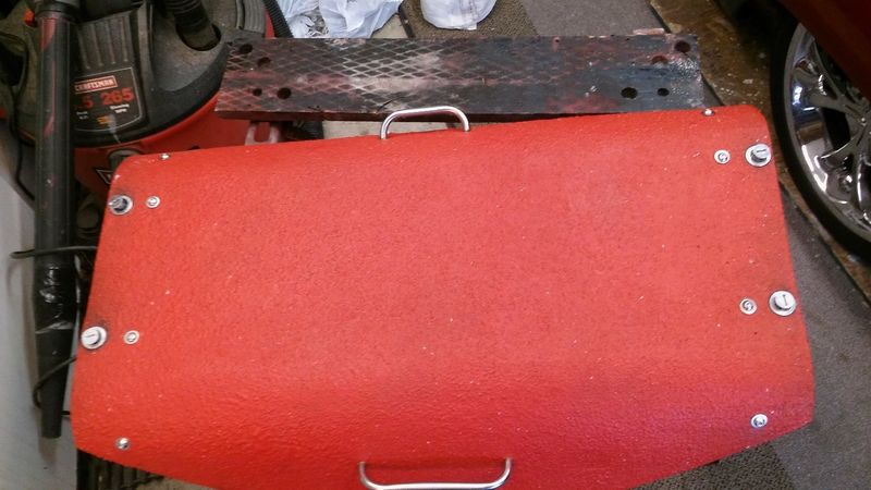

So my 2nd winter project is repairing the tabs for the aircraft type lock down buttons ( ZLoc fasteners). The tabs were welded to the edge of the notch cover body,not enough area to have any strength, hence they would bend!!
The fix, weld new tabs to a plate that goes under the notch body, which I attached with pop rivets so can be removed if needed!! Much stronger!!
At the same time I added strength to the two metal bands that are welded under the cover to keep from flexing, drilled & tapped the bands so stainless button heads could be inserted!

Here's the photo's

more photos

awesome gary. ive wondered what those locks were called. i was thinking about attaching my not cover the same way. good to know the lock receiver welded straight wont be strong enough. keep up the good work

Thanks Poot, if you use these ,which are very good, I straighten out the end of the tabs & used piece of the same thickness metal as a spacer under the tabs up against the notch cover while welding in place. Keeps them paced at the correct height!!
