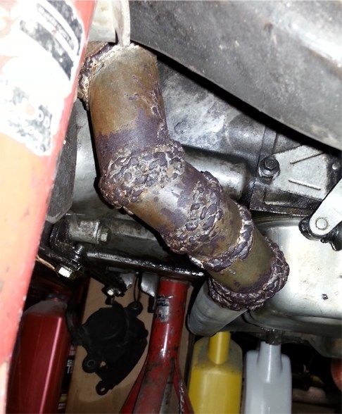

Sweet, Glad we have another build to follow. Keep the pictures rolling. I was digging the alignment of the exhaust in that side picture. haha.

Thank you, I have been pretty good about working on it on my days off. Thankfully the PO took that as a keepsake, he hung it on his garage wall. You should see the rest of it though, last owner fixed part of it with galvanized pipe and bubblegum. I will get a pic of it later today.

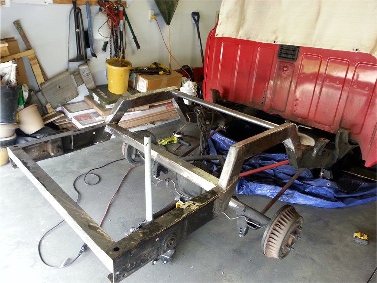

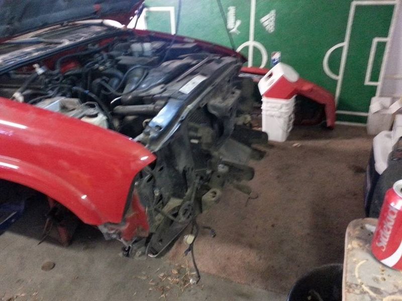

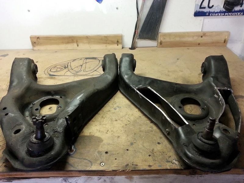

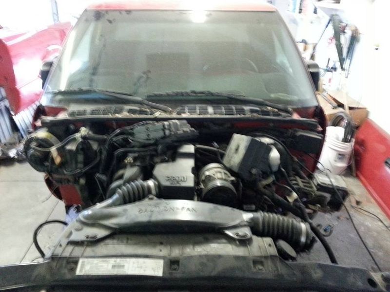

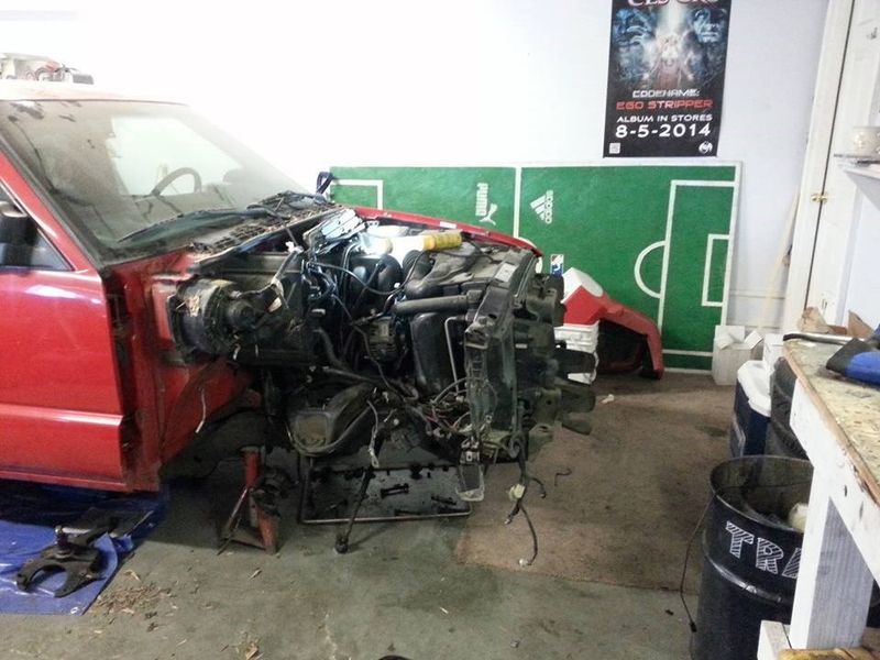

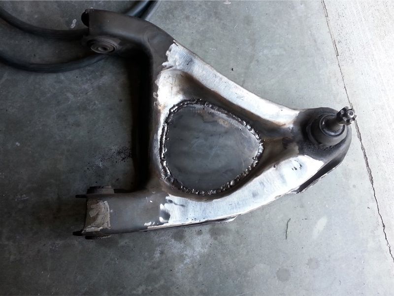

Got the front end pulled apart and the lowers off so I can de-hump and plate them, I am also going to plate the spring cups. I need to go get some more cutting wheels tomorrow and hopefully get these ready to mount the cylinders.

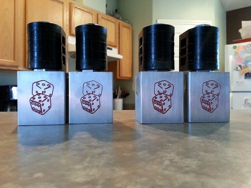

Had to take the day off to have a new furnace, water heater and AC installed. So during the down time I decided to finish up my dumps. I hand painted all the engravings on them, the slow downs and check valves. They turned out pretty good I think.

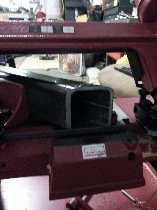

Finished dehumping and plating my LCA's, got that huge notch cut down and I am currently working on the bridge and rear cylinders. I also picked up an entire bed floor(minus tubs) from a friend, I have a few cool ideas I am going to eventually do but for now I just want to cover the notch hole and raise the floor, I might shave the fuel hose hump because it bothers me.

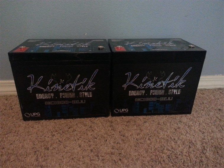

I am getting ready to order my accumulators, Kinetiks, and PP Ball joints. If I can keep this pace I should have her back on the road by the end of the month

Oh, and here is the rest of the exhaust I was talking about. The PO was just as proud of this as he was the flex pipe and coat hangers
