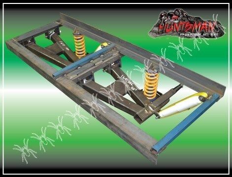

Yah I had mentioned airbaggedtrailers.com but the main concern is that your rear set of tires is being pulled down the road so I can only imagine what kind of damage would happen if your tire fell into a large pothole. I am leaning towards a control arm that points backwards to "drag" your tire rather than "push" them. But now the concern is do you put both axles on one control arm or build one short control arm per axle for each side.
broadband
Kind of like this system
