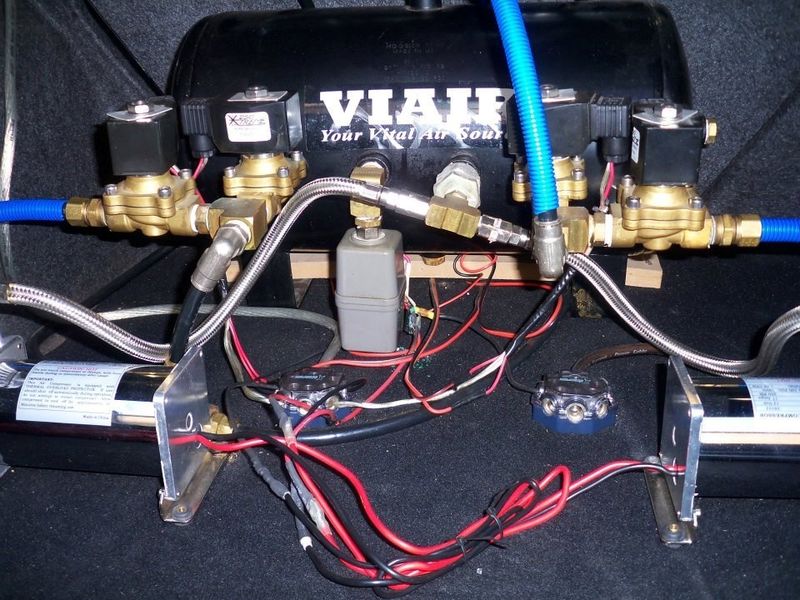

My accord air ride was working fine. Went to drive it the other day and back goes up fine, when i hit the switch for the front it just dumps all the air out the blow off valves that release when lowering. I have 2 Viar's, I have 1 line running up front which t-bones off to each cylinder, same with back ( Yes, I will be running individual lines soon as I get time.) Any help would be great!

I replaced some before. Would a stuck valve cause the air when hitting the switch be diverted right to the Release lines?Ive attached a sloppy pic of before I finished it to this

just check all the airlines going to the cylinders an the Ts in between the lines. your dump valve might be stuck open so when you go to air up its just dumping it right out if thats the problem. id also spray allthe fittings an valves down with soapy water to make sure theres no leaks from there either
