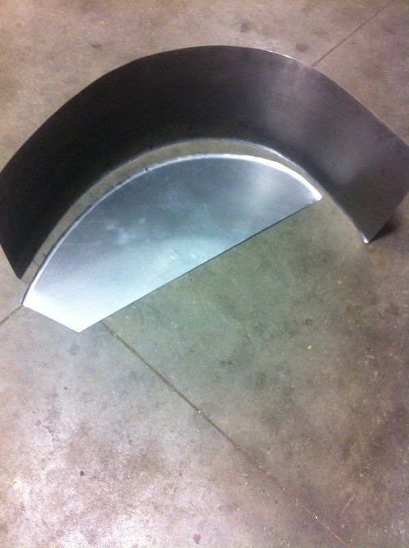

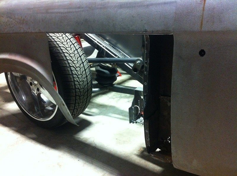

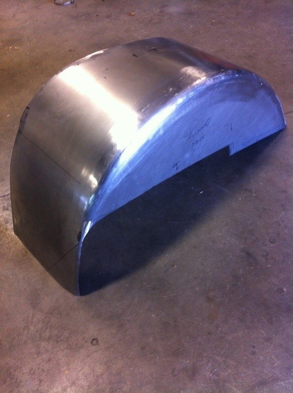

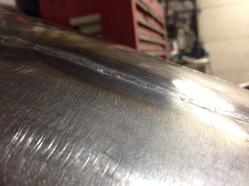

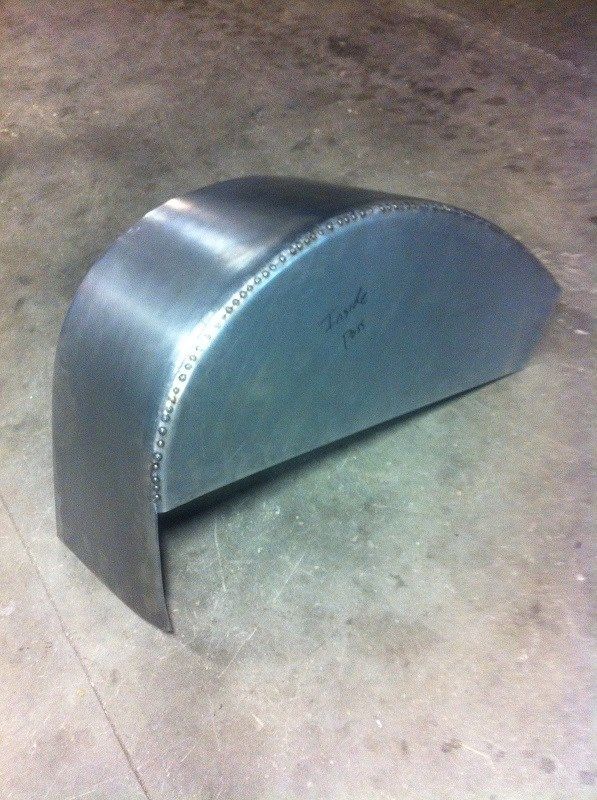

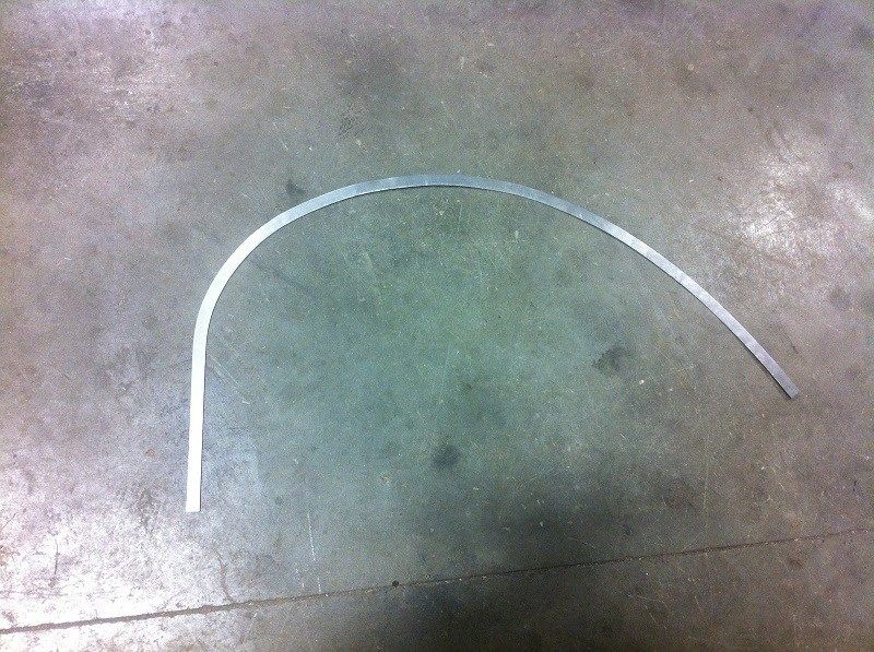

Lets see some advanced shaping and forming. Heres a set of teardrop wheel tubs im building for the F100. I make mine from 2 pieces and form the edges with my tank die in the bead roller.I make a template of the desired shape out of a piece of 3/4'' wide strap by stretching the outer edge (pic 3). I shrink the edge to be rolled, even more where the radius is tighter. After the edge is shrunk I run both edges through the roller to get the radius, then with a little more shrinking I have the 2 halves fitting together. Some welding, grinding, and filing and they are done. A little more time involved but looks way better than a welded square edge imo.

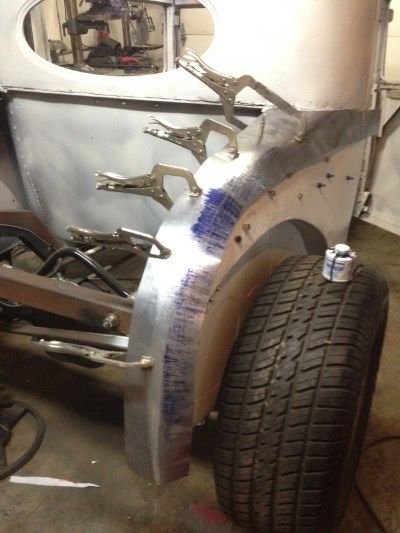

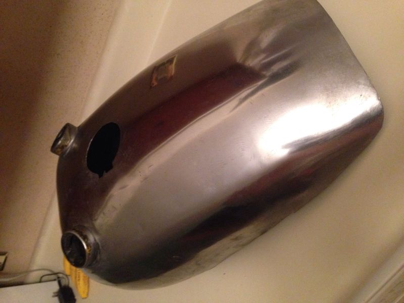

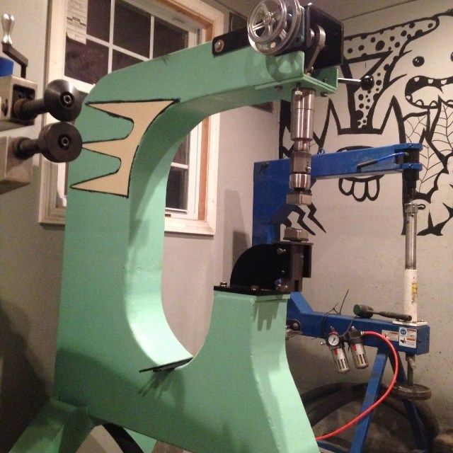

built a pullmax style machine.. then started on these 1/4's 2 nights ago.

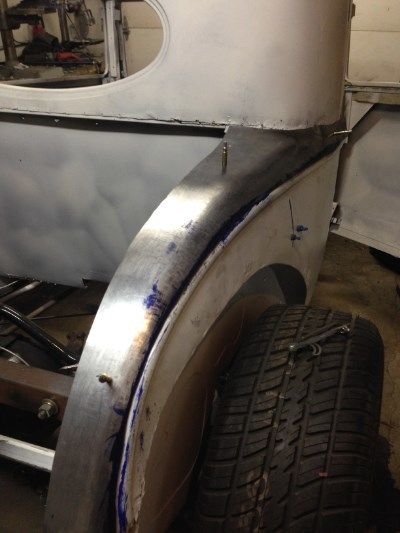

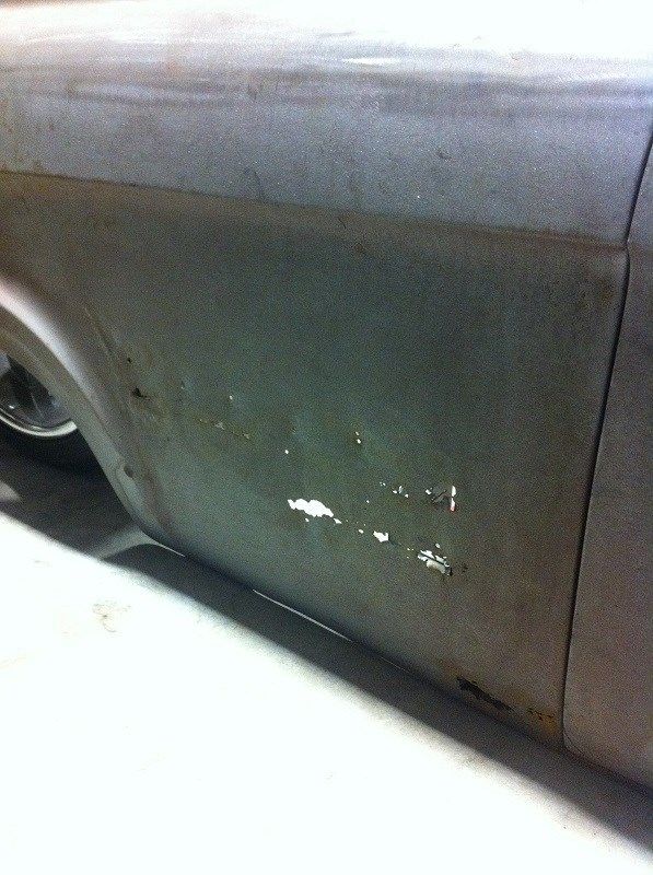

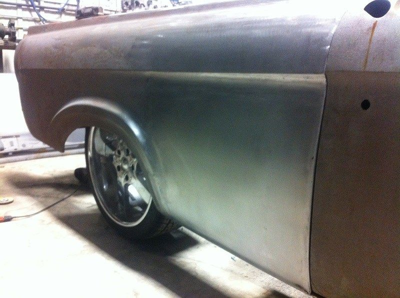

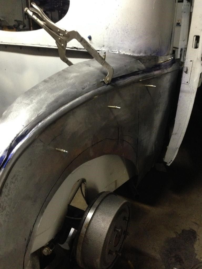

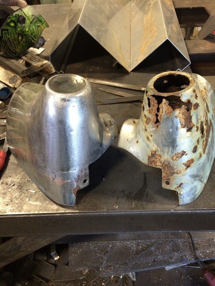

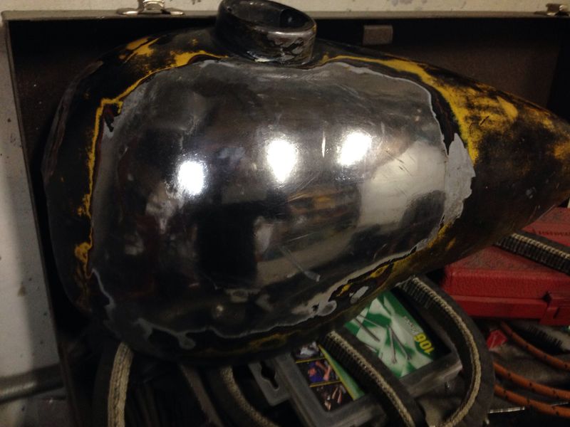

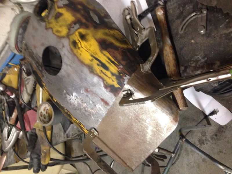

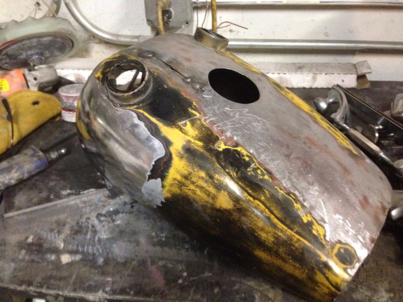

Awesome work. Did this one recently. Started with a shell...split it, fixed a dent, and extended it... Pics are out of order but you get the point
post photo post photo post photo post photo post photo post photo post photo post photo

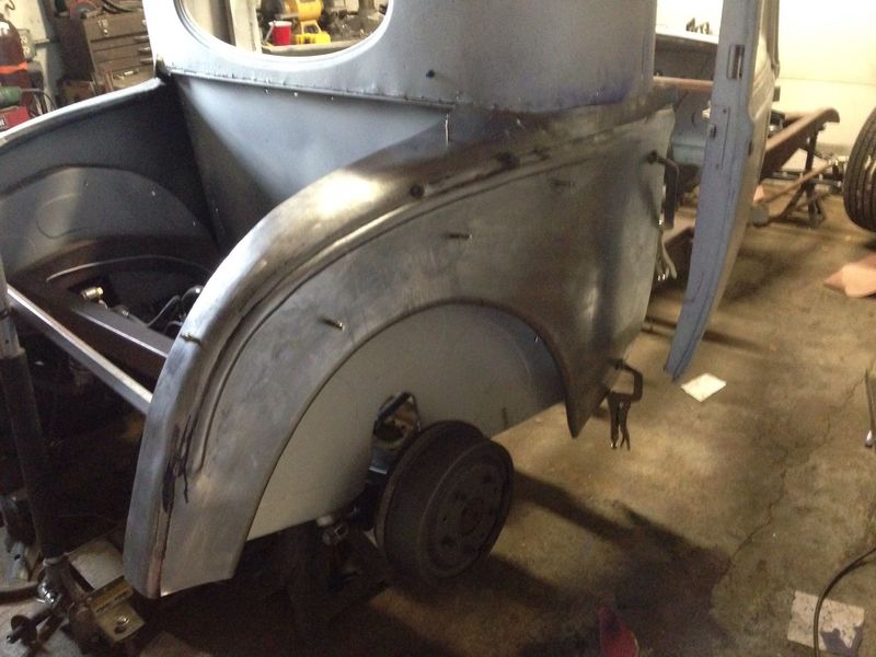

Day 3 on this. It'll look better soon

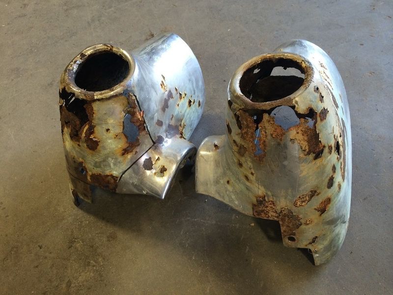

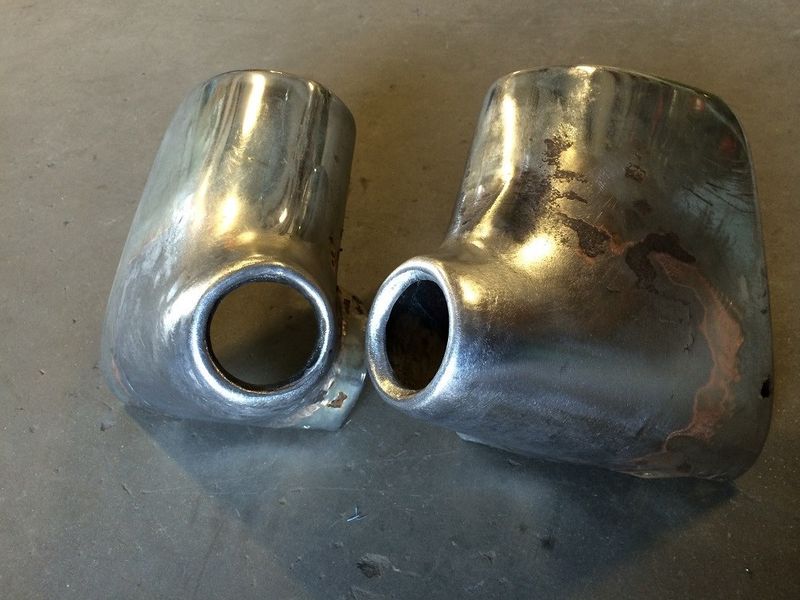

Redid the bumper ends on a buddys 55 caddy. Got about 13 hrs into them and after a little more filing theyll be ready for chroming.
