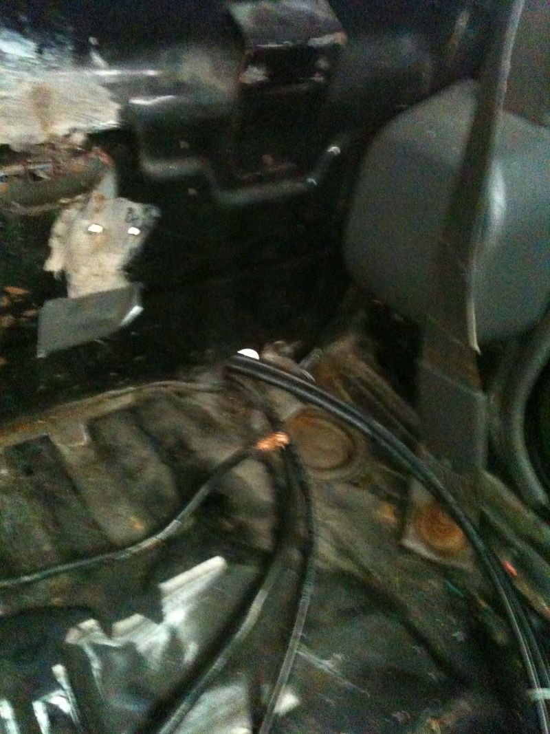

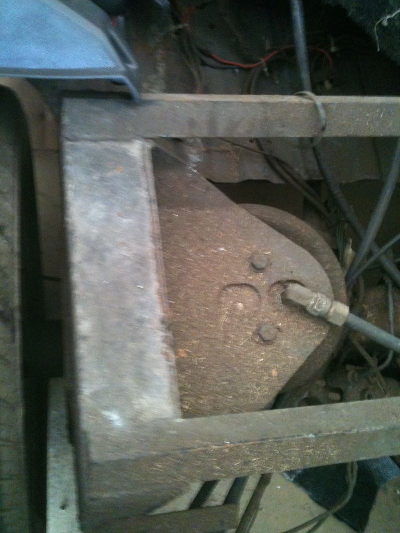

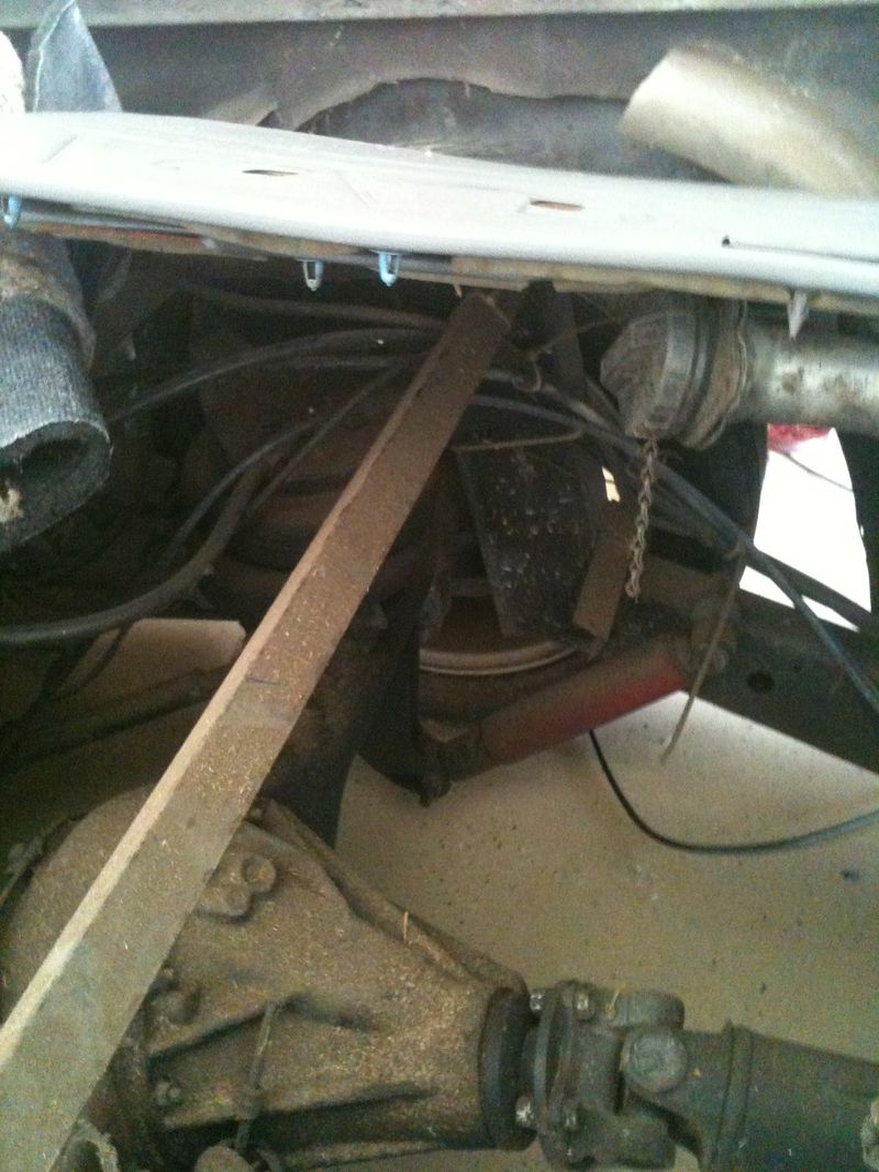

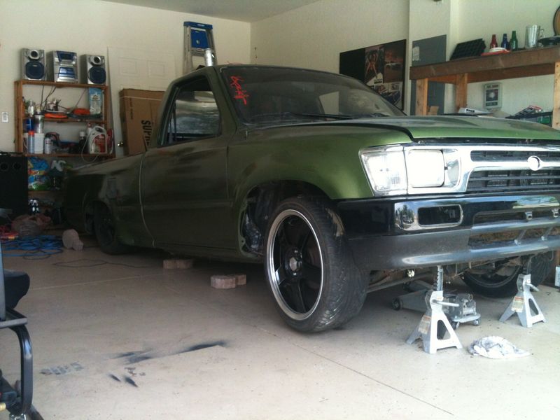

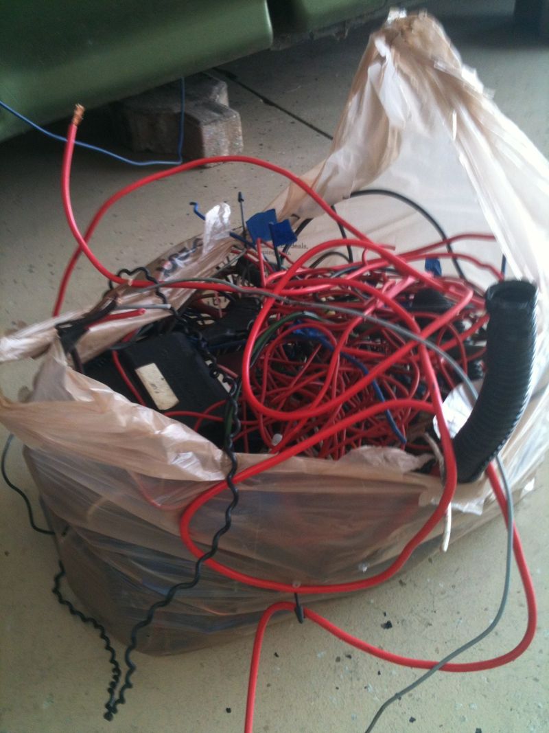

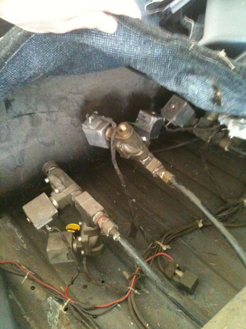

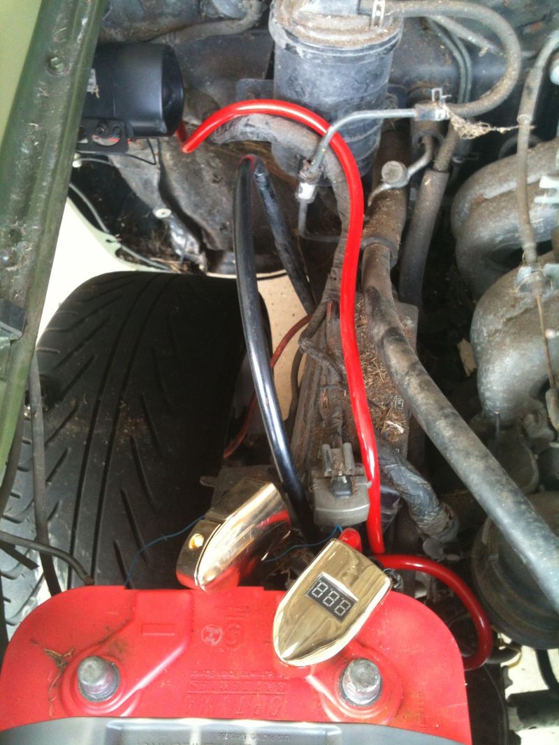

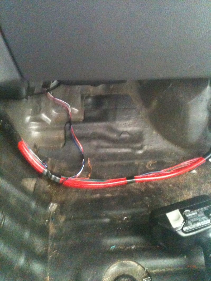

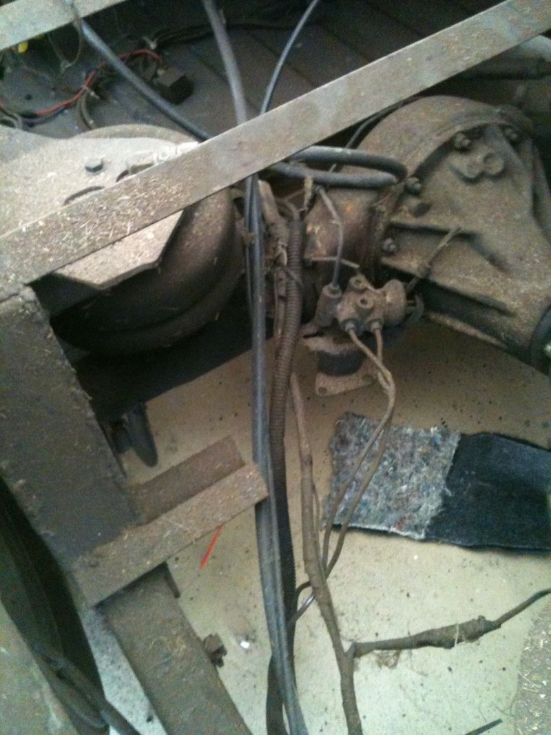

i would assume that it raises the tranny up but i have not messed with it at all i could be wrong. i do not know where it came from i traded my old mini for this one and i am having to redo everything on this turd the kid i got it from had no clue what he was doing he used angle iron as a cross member on the c notch the wiring was a rats nest under the dash the power wire going to the door poppers was spliced together 4 different times 4 different ways ill post some pics of it soon or what it was to what it is now

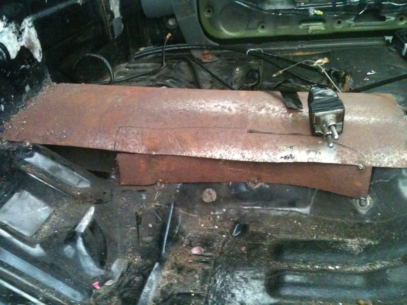

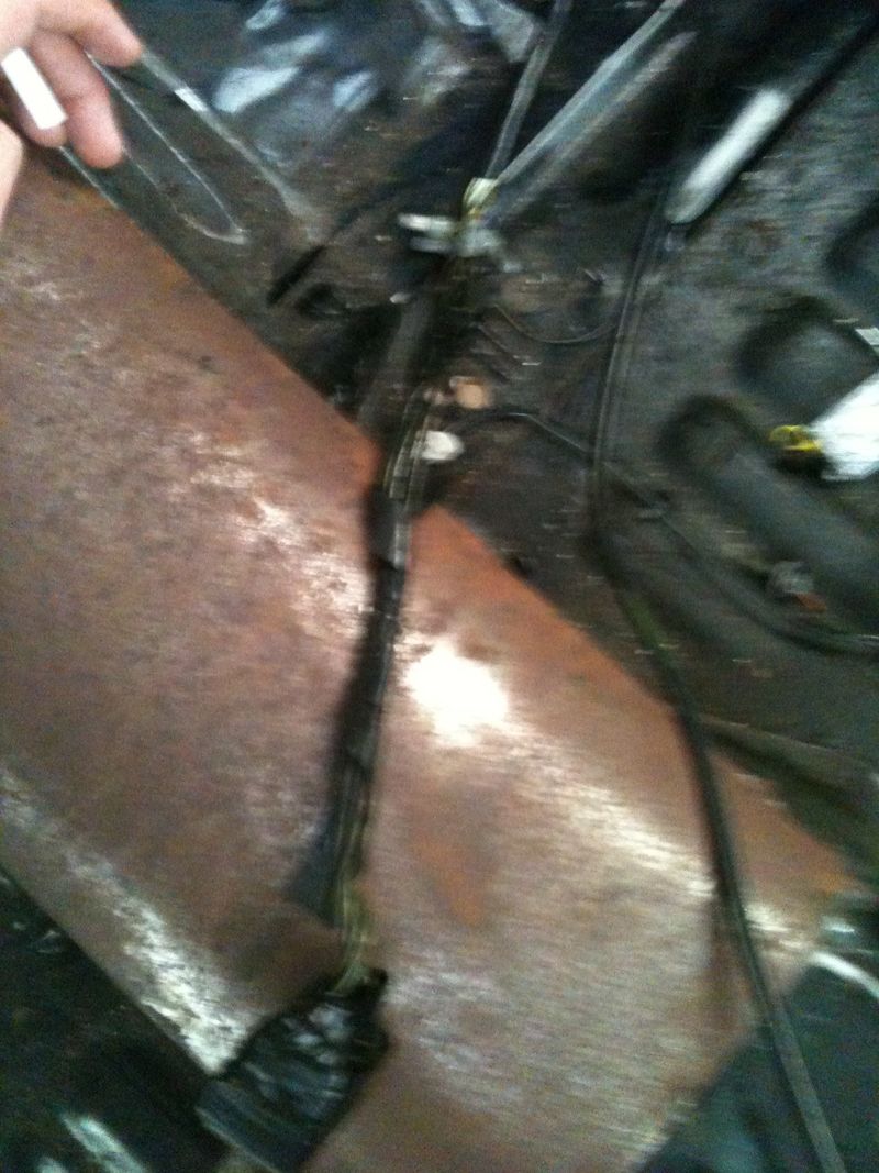

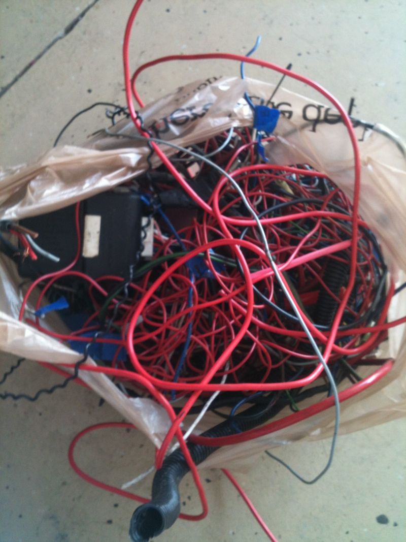

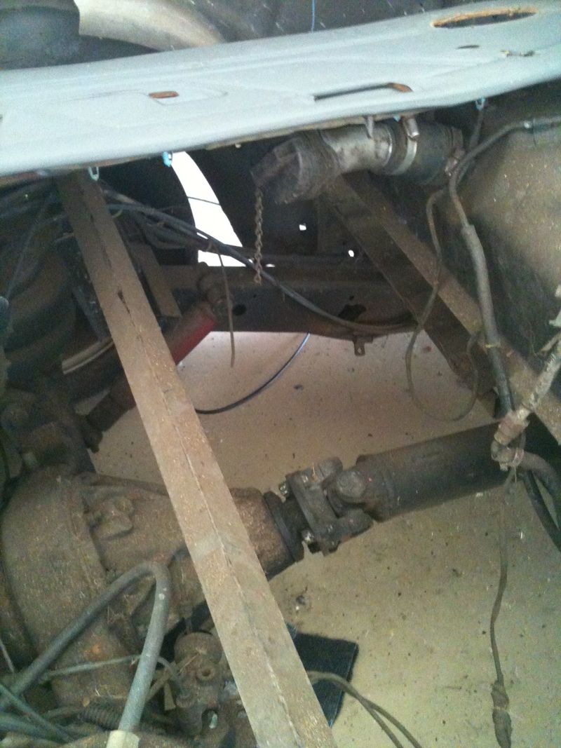

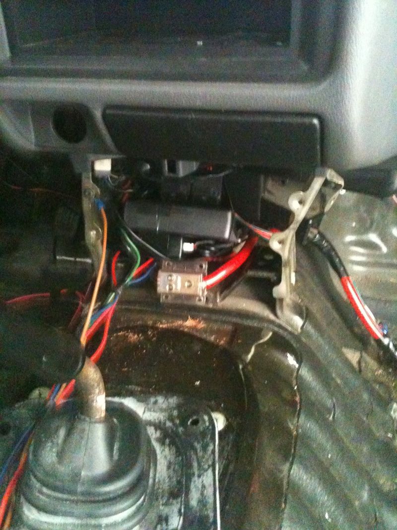

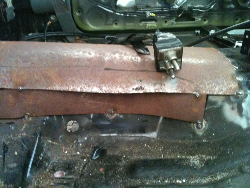

they are not in order from old stuff to new stuff but im sure you can figure it out the first and last pic are the wires i pulled out from under the dash

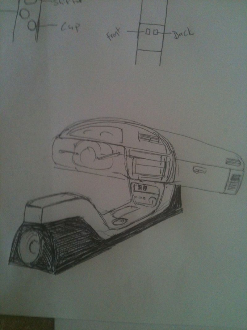

here is the center console i plan on building
