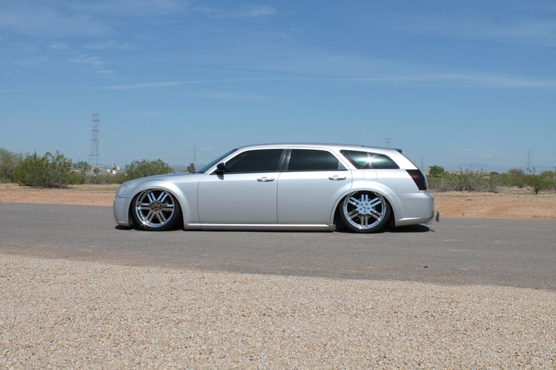

My buddy Scottie from Havasu came to me to get his Magnum all the way down. He juiced the car himself over a year ago, but it wasn't quite low enough for him. So we are cutting and trimming the necessary body parts to lay the rockers flat on the ground.
In the rear we leaned the strut towers inward because the tires were already hitting them. They were welded and then plated with 16 ga and welded again. (sorry for the blurry pics)
http://i328.photobucket.com/albums/l344/tre5peter/Scotties%20Magnum/IMG_2178_zpsb2cb3957.jpg
http://i328.photobucket.com/albums/l344/tre5peter/Scotties%20Magnum/IMG_2180_zps768b03c9.jpg
We also had to cut out for the tires at the front of the wheel well and notch for the half shafts and control arms, but I didn't get pics of that yet.
Up front we removed all the factory sheet metal, cut out for the upper control arm, and then for the tire.
http://i328.photobucket.com/albums/l344/tre5peter/Scotties%20Magnum/IMG_2195_zpse99a994c.jpg
http://i328.photobucket.com/albums/l344/tre5peter/Scotties%20Magnum/IMG_2196_zpsae89a678.jpg
Already started putting some sheet metal back in up front.
http://i328.photobucket.com/albums/l344/tre5peter/Scotties%20Magnum/IMG_2197_zpseaab964c.jpg
Jacked the tire up with the fender on.
http://i328.photobucket.com/albums/l344/tre5peter/Scotties%20Magnum/IMG_2194_zps37848f52.jpg
Then laid it out to see what we had accomplished.
http://i328.photobucket.com/albums/l344/tre5peter/Scotties%20Magnum/IMG_2199_zps19223398.jpg
Mission accomplished!
http://i328.photobucket.com/albums/l344/tre5peter/Scotties%20Magnum/IMG_2198_zps67eb3b31.jpg
We still need to tie up all the loose ends, so I'll take some more progress pics.

The rear was definitely more work. I notched for the half shafts, notch the pinch weld for the upper control arm, notch for the rear lower control arm, and drop the front lower control arm down with new tabs. Then tub for the tire... all with the quarter panel in the way. The front is much easier... take the fender off and you have a much nicer area to work in. All I did up front is what you see in the pics, cut out for the control arm and cut out for the tire.

Well, I have some finished photos but the new site says they're too big and when I resize them them the upload fails. So if you want to see them check out the Tre5 Customs facebook page or follow me on instagram @tre5customs
tre5's avatar
tre5
Here's a completed pic
