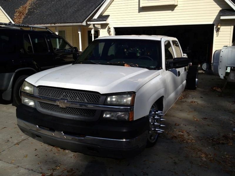

I make a kit for the 3500 trucks with the torsion bar suspension, i think yours has the same suspension...been making this one for a while now.
Its an upper control arm, lower control arm, raised upper arm bracket kit.
[img]http://sphotos-b.xx.fbcdn.net/hphotos-snc7/418504_461946037161985_1842904860_n.jpg[/img]
[img]http://sphotos-b.xx.fbcdn.net/hphotos-ash3/550132_513097025380219_1340522191_n.jpg[/img]
[img]http://sphotos-a.xx.fbcdn.net/hphotos-prn1/546484_390671097622813_1062238058_n.jpg[/img]
